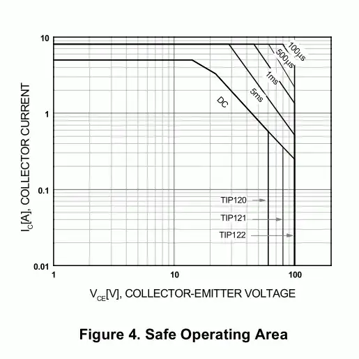

In a datasheet you will often find a graph that expressed the maximum current under various circumstances. In the graph below the DC and 5ms ... 100uS lines show the average-heat limits of the Safe Operating Area. They depend on the VCE, because the heat is generated in the semiconductor area where this volateg drop occurs. The horizontal line at 5A is the DC limit. It is (for a large part) independent of the VCE, because it is about a bonding wire, which is Ohmic (voltage drop and hence heat is determined only by I * R).
There are other limits, like the maximum emitter-collector voltage, that are also expressed in this diagram.
