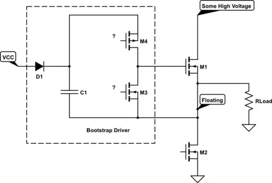

What I don't understand is the high-side driver circuitry itself. Since a good driver pushes and pulls large amounts of current, it makes sense that another pair of transistors exist within the IC to drive the VH pin high or low. Several datasheets I've looked at seem to indicate they use a P-channel/N-channel pair (or PNP/NPN). Taking away the construct of the IC chip, I imagine the circuit looks something like this:
It seems that we've just introduced a recursion problem. Assuming the node marked as "floating" can be any arbitrarily high voltage, how are M3 and M4 driven that doesn't need yet another driver to drive the driver (and so on and on)? This is also assuming the high-side driver is ultimately controlled by a logic-level signal of some kind.
In other words, given an arbitrarily high floating voltage, how is the push-pull drive of M3 and M4 activated by a logic-level signal that originates from off the chip?
Point of clarification: The specific question I'm asking has only to do with activating the high-side push-pull bootstrap drive with a logic-level signal. When the high-side voltage is relatively low, I recognize this is trivial. But as soon as the voltages exceed typical Vds and Vgs ratings on transistors, this becomes harder to do. I would expect some kind of isolation circuitry to be involved. Exactly what that circuitry looks like is my question.
I recognize that if M4 is a P-channel FET (or PNP), another bootstrap circuit is not necessary. But I'm having trouble conceiving of a circuit that will generate the proper Vgs's for both M4 and M3 as the external transistors are switched back and forth.

    Nick, I actually found that answer earlier before posting my question (although the fact I used the same image from the FAN7380 datasheet is a coincidence). I'm fairly comfortable with using a driver IC with a bootstrap gate drive. The specific question I'm asking is what the gate drive circuit actually looks like. The box marked as just "driver" in the image. Basically, specific details about step 4 of your answer to that earlier question. – Dan Laks Nov 04 '14 at 03:27
  • The inside of the driver box could be a push-pull pair of BJTs [like that](http://i.stack.imgur.com/BJtRt.png) (originally from [this thread](http://electronics.stackexchange.com/q/74465/7036)). One pair can drive the N-channel M3. Another pair can drive a P-channel M4, because it doesn't require a supply rail that extends above its source. It's not uncommon to have multiple stages within the gate driver. – Nick Alexeev Nov 04 '14 at 03:40
    Right, the push-pull pair is what I figured in my question. I'm still missing something though. How does the push-pull drive activate for arbitrarily high floating voltages? That's the crux of my question, I suppose. – Dan Laks Nov 04 '14 at 03:51

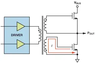

Pulse transformer is a spacial type of transformer for transferring rectangular pulses. They have less number of turns in order to avoid parasitic capacitance and inductance and larger cores for compensating loss of inductance due to reduced number of turns. They are much faster than optocouplers. Delay times are less than 100ns in general. The image above is for illustration only. In practice, the current they can provide is not enough for driving a MOSFET fast; so they need additional circuitry in practice.

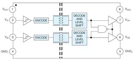

Isolated Gate Driver
Isolated gate driving is a relatively new technology. All the complexity of gate driving is encapsulated in one single chip. They are as fast as pulse transformers, yet they can provide a few amperes of peak gate current. Some products also contain on-chip isolated DC-DC converters, so they don't even need boot-strapping. However, all these super features come with a cost.

  • Hi, I see the last image you provided is very similar to the schematic of the ADuM3220 gate driver. My question is if this requires bootstrapping to power the high-side MOSFET? IF not, do you have an example of a product with an on-chip isolated dc-dc converter? Thanks – rrz0 Apr 09 '18 at 16:38
    @Rrz0 In [this table](http://www.analog.com/en/parametricsearch/11102), for a product listed in a row, if the string in the column "Isopower Enabled" is "Yes", then it has internal DC-DC power supply. – hkBattousai Apr 10 '18 at 07:35
