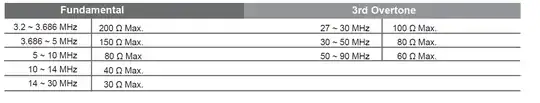

First, you have a crystal not an oscillator.
Majenko's comments on the load capacitor are correct, you should have roughly 30pF on each side, but that's not your biggest problem (load capacitor problems can only pull the crystal frequency slightly).
The crystal is a 3rd overtone type so it will oscillate at 1/3 the marked frequency unless you add some tuned circuit to encourage it to oscillate at 48MHz. As you can see from the datasheet the fundamental crystals in this series only go to 30MHz.
You really shouldn't be using such a high frequency crystal anyway if there is any other way- using a PLL internal to the micro to step up a lower frequency crystal is a common ploy. Crystals are best between about 4MHz and 20MHz, higher or lower and there are drawbacks.
If you really insist on 48MHz for some reason, maybe you should actually buy an oscillator which will have the required crystal, tuned circuit, and amplifier circuitry inside one package, guaranteed to work.

  • I had a look at what you said about the tuned circuit, the microcontroller has an inbuilt 'pierce oscillator' which, if I am not mistaken' would work as a tuned circuit? – MrPhooky Nov 04 '14 at 09:34
  • No, it's not tuned at all except by the crystal and that wants to oscillate at 16MHz preferentially. Read [AN016](http://www.silabs.com/Support%20Documents/TechnicalDocs/AN0016.pdf) for recommended fundamental mode crystals (and caveats) or use an external oscillator as the mfr does not appear to support 3OT xtals. – Spehro Pefhany Nov 04 '14 at 09:54
