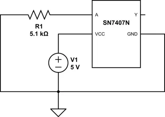

So the next thing I did is connect a 5.1kΩ pull-down resistor R1 to A like so:
simulate this circuit
Now, when I measure the voltage at A, the meter reads 1.6V (a drop of .3V).
Q: Since the pull-down resistor is supposed to create a low-level at the buffer's input, why doesn't it show something closer to 0V at A?
Measuring at Ynow shows .9V, which maintains the roughly .5V difference I saw when nothing was connected, but the voltage at Y still appears to be too high to present a true low condition.

Note that the input is relatively low impedance (having a 6k pullup to Vcc through the emitter-base junction (which effectively looks like a diode) of the transistor shown). The datasheet says it requires 1.6mA to pull the input low (parameter IIL). This is a lot of current compared with the few microamps, nanoamps, or picoamps typical of CMOS or other high-impedance inputs.
A 5.1k pulldown resistor is too large to pull the low impedance input down. With 1.6mA flowing through 5.1k, the voltage drop (calculated via Ohm's law) would be 8.16 volts. To pull the input down below 0.8 volts, you would need a 500 Ohm or smaller resistor. I would suggest trying 330 Ohms.

    Thank you for the edit. The 330Ω resistor did the trick--it works perfectly now and I've learned something new! – par Oct 31 '14 at 01:16
    Awesome! Glad I could help. – ken Oct 31 '14 at 01:45

Looking at the data sheet schematic, you can see that the emitter of the input transistor is floating, while its base is pulled up to Vcc internally, and if you follow the chain you'll see that eventually that buffer's output will be forced into its open-collector state with the emitter open circuit/floating.
In order to turn the output OFF, then, the emitter of the first transistor must be pulled close enough to ground to reverse the chain of events through the buffer, and that's done unequivocally by pulling the emitter down to 0.8 volts or lower.
The price for doing that is 1.6 mA out of the emitter, so with that and Ohm's law in mind we can solve for the pulldown resistor like this:
$$\ R=\frac{E}{I}=\frac{0.8V}{1.6 mA}=500\Omega $$
and come to the conclusion that the reason the buffer wouldn't switch was because the value of your input pulldown was too large to allow 1.6 mA through it and consequently, the drop across it was higher than 0.8 volts.
