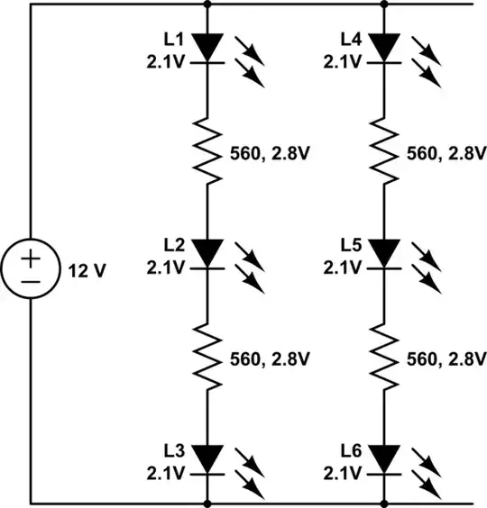

I recently bought these LED strips. They are supposed to run on 12V/72W and have 300 x the SMD 5050 LEDs on it. Schematic:
simulate this circuit – Schematic created using CircuitLab The voltage values on the schematic have been measured with a multimeter. "560" is written on the resistors.
As you can see, the resistors account for 5.6V - that makes 46% of the voltage (or power) consumed by the strip!! Is that normal?

    They're not built to be efficient, they're built to be cheap. – Ignacio Vazquez-Abrams Oct 29 '14 at 13:24
    Inexpensive Chinese-made products solving everyday engineering problems in the cheapest way possible? Yes, that's normal. – Phil Frost Oct 29 '14 at 13:51
    Not sure your schematic is accurate. 5050 leds are 3 diode packages. You should sacrifice a segment to figure out the layout. – Passerby Oct 29 '14 at 14:04
    Also these strips were designed with automotive 12V in mind, which is between 10 to 14V typically. So just get a lower voltage supply... – Passerby Oct 29 '14 at 14:56
    @Passerby you are right - one diode in my schematic represents a 5050 SMD with 3 diodes in parallel - I was lazy there – dergerhard Oct 29 '14 at 15:01

This is normal enough. This is done because
  • People are being lazy, cutting corners and cost and reusing strip backing which is also used for white LEDs.
  • Because they can
  • You are 1000's of km away, they do not expect repeat business, they do not care what you think.
These strips allow 3 LEDs in series to be connected across the supply. when white or blue LEDs are used Vf (forward or operating voltage) per LED is typically in the 3.0 to 3.5 Volt range or 9 to 10.5V typical. When operated on 12 Volts they thus dissipate 9V/12v tp 10.5V / 12V or 75% to 85%+ in the LEDs. when Red LEDs are used Vf is about 2.0 - 2.2vper LED or 6V to 6.6V total resulting in the result that you see. If they cared they could make a design that uses 4 LEDs in series (8V - 8.8V) or just possibly 5 in series (10V-11V) although the latter has too little head-room voltage dropped acrtoss the resistors.
If you care enough about the excess dissipation and if the resistors are accessible you could sort out one series resistor per 3 series LEDs and operate then from around 10V or short out two resistors and run then from about 8V. This is quite a lot of work and unlikelt to be attractive except where power use if of vital importance.
Interest only: If dissipation at 12V is 72 Watt then dissipation when modfied to run on 8V would be abpt 48 Watt - or 24 Watt less. If run "24/7 for a whole year (8765 hours) and if electricity costs 25 cents per unit then after one year of continuous use you would have saved about $50 in power costs!.
[ 8765 hours x 24 W/*1000 W/kW) x $0.25 = $52.59
Adjust figure for actual hours/day and unit cost of energy.
If you ran these continually for 8765 hours it's likely that their light output would be much reduced. The reasons for those are the same as those at the top of this answer.
Added:
As Olin says, they will be 56 Ohm resistors.
I = V/R = 2.8/56 = 50 mA.
As far as I can tell from the image the LEDs use 3 die in parallel (each brought out on two pins) and then a resistor connects to the next LED in a set of 3. Each die is probably rated at 20 mA max so 60 mA for 3 - so running at 50 mA is slightly conservative which is good.
This is a very unusual design as only one series resistor is strictly necessary per set of 3 LEDs. Thy may have done this so each resistor dissipates 140 mW instead of having one only but needing it to dissipate 420 mW. This MAY be OK but it is likely that th

First "560" on a resistor means 56 Ω, not literally 560 Ω. This is essentially a floating point format. The last digit is the exponent of 10 to apply to the integer value formed by the previous digits. "560" therefore means 56 x 100 = 56.
Yes, this LED array is quite inefficient. If that's a primary concern, don't use it. It seems the design was optimized for cost. I expect it was cheap, so you got what you paid for.

560 on an SMD resistor is typically 56Ω - that's a five, a six, and zero noughts.
So if you have 12V, three LEDs, and 112Ω of resistance, and assuming 2.1V voltage drop across an LED, the sums work out as:
\$V_{FT} = 2.1*3 = 6.3V\$
\$V_{RES} = 12 - 6.3 = 5.7V\$
\$I = V/R = 5.7 / 112 = 51mA\$
Blue LEDs have a higher forward voltage, normally - say 3.2V. Using the same components that would work out as:
\$V_{FT} = 3.2*3 = 9.6V\$
\$V_{RES} = 12 - 9.6 = 2.4V\$
\$I = V/R = 2.4 / 112 = 21mA\$
Blue LEDs are visually brighter than red ones, so less current through blue LEDs is acceptable (though not necessarily "nice").
By using the same components throughout they keep costs down. Three blue LEDs is the limit for a 12V supply, so you are stuck with 3 LEDs on the red version (same PCB), and keeping the same resistors, while not "ideal", is fairly normal. Yes, it means the resistors drop more voltage on the red one than the blue one, and the current is higher, but that's a small price to pay for having very cheap LED strips.

Solder in bypasses on the first resistor on each series, and replace the second resistors with a 20R, and make sure you use a switching power supply and keep the voltage under 7V - this should dramatically increase efficiency. You can pick up a reel of surface mount 20R resistors, and set if you create a custom soldering head to "stamp" them in it should be fairly efficient to get the job done.
Another way I have done it is to buy bulk flat LED lights and wire them all up myself.
Ideally each the LED's should be wired in groups of each colour with a set resistor for each colour, or even better, each colour is run on its own complete circuit (allows for colour mixing).
