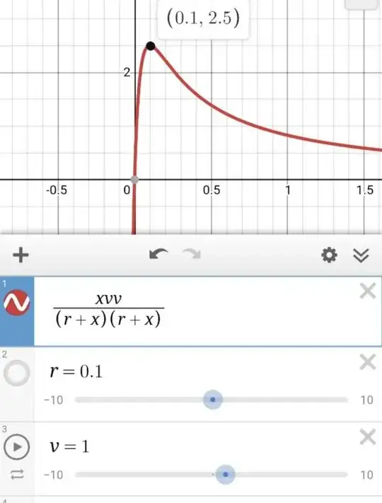

Impedance matching is simply how to maximise the power of the load, when we want to get the maximum power out of a power source, typically when it's an information signal. This becomes an issue when the load is in series with some impedance, like a transmission line.
In a simple case this can be modelled as a circuit where you have the power source, a resistor representing the resistance of the source, and a resistor representing the resistance of the load.
We can then calculate power of the load as
$$P = \frac{R_LV^2}{(R_S+R_L)^2}$$
Because the power is the V drop over the resistance of the load times the current, and the V drop over the load is $$\frac{R_LV}{R_S+R_L}$$ i.e. the ratio of the load in the total resistance of the circuit multipled by the total potential change, and the current is obviously $$\frac{V}{R_L+R_S}$$
P wrt. RLhas a plot: enter image description here
When using 1V and RS = 0.1, you can see that RL has maximum power when RL = RS.
