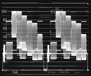

I'm learning the basics of analog and digital TV signals and I came across this (original link, now gone) short article (see the next page as well).
Why can't analog video signals be compressed in a similar way to digital signals when using MPEG-2 (refer to the article above where they give a basic example of what I understand by MPEG-2)? why can't "repeated" pixels be ignored in analog to reduce the bandwidth usage as in digital?
To see what I mean refer to this question. There you can find the following picture:
Why can't you simply "ignore" (by not modulating it) a line of pixels (assuming it didn't change between frames) and reduce the data signal frequency and therefore the bandwidth usage?

    Because analog has no means of encoding repetition. – Ignacio Vazquez-Abrams Oct 28 '14 at 22:54
  • How would you transmit the information about how many pixels to ignore, how to reconstruct the signal, etc? – John D Oct 28 '14 at 22:54
  • @JohnD Ok I will expand a little from what I understand. – 4nt Oct 28 '14 at 22:57
    I'm somehow stuck at the point you say "why can't repeated pixels be ignored in analog to reduce...". Analog = continuous, not discreet. Analog doesn't have pixels. – woliveirajr Oct 29 '14 at 14:20
  • @woliveirajr It doesn't really matter, the question still stands. If you prefer think of removing repeated "patterns" in the wave (I used pixels because the article talks about digital), that way you would accomplish the same as in digital, that is to reduce the amount of data transferred. – 4nt Oct 29 '14 at 19:02
    All points about the limitations of analog processing aside, the compression you suggest for analog use is essentially RLE (run-length-encoding; about the simplest and least efficient type of compression). It is not particularly suitable for video compression, as few pixels remain exactly the same from one frame to another or compared to their neighbors. MPEG-2 and most other digital video compression schemes are based on the discrete cosine transform and motion prediction, among other schemes that operate on discrete/sampled/digital data. – bcrist Oct 29 '14 at 22:24
