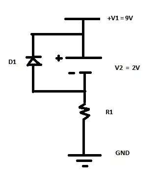

This question originates from a difficulty to understand fly-back diode current in DC motors.
In the above figure which logic is ok: 1) 9V-2V = 7V, so diode is reverse biased and current will not flow. 2) diode is applied 2 volts forward bias in a loop so current will flow from the source V2
Which logic is valid?

The diode will only see the 2 V forward, so the current will flow. The diode is directly connected to the 2 V generator so everything outside doesn't matter (excepted short-circuit and so on of course), if you can measure 2 V at the generator then there is also 2 V at the diode.
But you'll not have 2 V at this point, you'll have the diode drop (0.6 to 0.7 V for silicon and 0.3 for schottky diodes for example) or a fried diode if the current is too high...
EDIT (Since the OP has edited his question my answer just above is no longer valid):
The diode will only see 2 V in reverse (or -2 V in the conventional reading direction of a schematic), so the current will not flow. The diode is directly connected to the 2 V generator so everything outside doesn't matter, if you can measure 2 V at the generator then there is also 2 V at the diode.
So you'll have 9 V accross the whole thing, -2 V accross the diode and +9 + -2 = 7 V accross R1.
EDIT² (answer to the secondary question: Where will the current flow when V1 = 9 V and then V1 = 0 V?)
Since the diode isn't conducting there is only one current path and it will be from V1, through V2, then trough R1, then to GND when V1 = 9 V.
When V1 = 0 V (connected to GND in other words) the path will be the same but the current will flow in the reverse direction (but the diode will still be reverse biased and not conducting, don't forget the diode is still directly connected to the generator V2 so everything outside doesn't matter).
From a different point of view: if you think that V2 is like a battery, when V1 = 9 V you recharge it through R1, and when V1 = 0 V then you discharge it directly through R1.
EDIT³ (new schematic and new secondary question: Where will the current flow when Q1 is closed and then opened?)
With this new schematic when Q1 is closed (let's assume it's a perfect transistor) the path and current direction will be the same as in my edit² when V1 = 9 V.
When Q1 is opened there is no path where the current can flow so there is simply no current flowing.
Biduleohm
  • 359
  • if V1 is supply and V2 is back emf of a DC motor, it is said that back emf opposes the supply voltage. but if current flows through the diode(shorts) how can it oppose V1? will current from back emf flow through the diode in that case? – user16307 Oct 25 '14 at 19:25
  • It's because the back EMF isn't in this direction, it's opposed to V1 (in your schematic V2 is effectively in series in the same direction as V1), see [this article](http://en.wikipedia.org/wiki/Counter-electromotive_force) and [this video](https://www.youtube.com/watch?v=qwtiX3pFCIE) for more information. – Biduleohm Oct 25 '14 at 19:28
  • oh ok i updated the figure. here my confusion is this: lets say there is pwm and when 9V exits in ON mode or doesnt exist in OFF mode, where will the current from V2 flow through? thnx for video but they dont show current flows. my problem is icturing where the current flow from V2 (back emf current) – user16307 Oct 25 '14 at 19:34
  • The diode is reverse biased. 9V at the cathode, and 7V at the anode. – krb686 Oct 25 '14 at 19:44
  • @user16307 Edited my answer, it should be clear now ;) – Biduleohm Oct 25 '14 at 19:50
  • thnx for explanation. but my confusion is about current loops. but am asking this question maybe 10 times including other posts but no answer. and mentioning where will the "current flow". i write it again: here my confusion is this: lets say there is pwm and when 9V exits in ON mode or doesnt exist in OFF mode, where will the current from V2 flow through? thnx for video but they dont show current flows. my problem is picturing where the current flow from V2 (back emf current).where will the current flow through from V2(back emf) can you tell me the loop? – user16307 Oct 25 '14 at 20:20
  • Edited again to add the answer to this question. – Biduleohm Oct 25 '14 at 20:31
  • you wrote "When V1 = 0 V (connected to GND in other words)". i think here is the center of my confusion. When V1 = 0 V does that mean it is GND? i dont understand this. plus my real figure supposed to be like this:http://i.imgur.com/1wRtR6F.png if OFF there is still +Vmotor – user16307 Oct 25 '14 at 20:49
  • pls just last question here: http://i.imgur.com/1wRtR6F.png in OFF(Q1 off) mode can u tell me where the back emf current flow? – user16307 Oct 25 '14 at 20:52
  • If V1 = 0 V then V1 = GND (as GND = 0 V, always). But the new schematic is different, you don't switch V1 from 9 V to 0 V then to 9 V etc... I'll edit a third time to answer with this new schematic. – Biduleohm Oct 25 '14 at 20:52

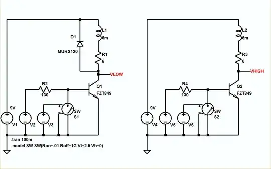

THE PUDDING:
Here are two identical circuits except for the flyback diode:
and here is the LTspice circuit list so you can run a simulation and see what the flyback diode really does.

  • I hate to be the bearer of bad news, but I think you're slightly confused. http://goo.gl/6arjuU – krb686 Oct 25 '14 at 19:42
  • @krb686: Oops... I was working on the original question before it got edited. – EM Fields Oct 25 '14 at 19:53
  • my confusion is about current loops. but am asking this question maybe 10 times including other posts but no answer. and mentioning where will the "current flow". i write it again: here my confusion is this: lets say there is pwm and when 9V exits in ON mode or doesnt exist in OFF mode, where will the current from V2 flow through? thnx for video but they dont show current flows. my problem is picturing where the current flow from V2 (back emf current).where will the current flow through from V2(back emf) can you tell me the loop? – user16307 Oct 25 '14 at 20:21
  • @EMFields sorry the real figure would be here:http://i.imgur.com/1wRtR6F.png and the quesiton is when Q1 is off where will the current form back emf flow? will back emf same polarizaiton during Q1 is ON and OFF? – user16307 Oct 25 '14 at 22:14
    @user16307 short answer: no current flows when Q1 is off; polarisation is the same (why it would change?), long answer: see my edit ;) – Biduleohm Oct 25 '14 at 22:42
  • yes i was thinking the same since i approve it with scope. but here:http://electronics.stackexchange.com/questions/135837/what-is-the-path-taken-by-the-back-emf-current peterG says polarity of back emf will reverse and current will flow through the diode. thnks so conclusion is NO current flows since there is no ground and the diode is reverse biased. – user16307 Oct 25 '14 at 22:52
  • diode then is not for backemf it is for L di/dt sudden voltage peaks during ON OFF switches – user16307 Oct 25 '14 at 22:53
  • see the comments to Bruce Abbott here: http://electronics.stackexchange.com/questions/135837/what-is-the-path-taken-by-the-back-emf-current/135898#135898 – user16307 Oct 26 '14 at 10:49
  • @user16307: Yes, the diode is to keep the high-voltage Ldi/dt spikes from punching through the driver. Back EMF won't be a problem because it can never exceed the supply voltage. – EM Fields Oct 26 '14 at 13:36
