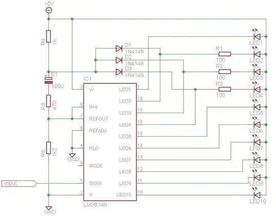

I'm wanting to turn a transistor on when any LED from LED2 through LED10 are on with an LM3914 in dot mode.
Basically, I want the transistor to be normally off until at least LED2 begins to light (using dot mode). Edit: there is some confusion with the diodes D1,D2,D3, and the capacitor C1. This causes LEDs 2,3,and 4 to blink when their on state is triggered based on this answer here: Make three respective LEDs blink with an LM3914 in dot mode
The answer to my new question needs to let the transistor be a solid on and not turn on and off with these blinking LEDs 2-4 in the schematic below:
Here is a picture of the circuit I'll be using for the LM3914.
klcjr89
  • 191
    Why are LEDs 2, 3 and 4 wired differently to the other LEDs? And what are the diodes D1-3 for? – Andy aka Oct 19 '14 at 20:14
  • If "dot mode" is selected, I assume only one LED will be on at a time, except for the brief period the display moves from one segment to another? (The datasheet talks about one fading out while the next fades in.) And if LED 1 is on, you want the transistor off also. – tcrosley Oct 19 '14 at 20:20
  • @Andyaka they're wired differently to blink those respective LEDs when their on state occurs. (only 1 blinks at a time) – klcjr89 Oct 19 '14 at 21:49
If you power LEDs 2 to 10 via a small resistor, you can look at the volt drop across this resistor to see that at least one of those LEDs is activated. You might need to use a comparator.
Alternatively you could diode-or outputs LED2 to LED10 to "acquire" the same information. Any one of those outputs going low would be seen on the common point of the diode-or gate as a low going signal. A resistor from the common-anodes of the diode-or up to 5V is also required.
EDIT SECTION - the question has changed slightly - the lower three blinking LEDs would cause a direct implementation of my above answers to "blink" the detection signal. This can be "put right" by adding a monostable circuit after the comparator or diode-or gate in order to keep the detection signal "valid" throughout the blink process. Should LED2 to 10 be turned off during the time delay added by the monostable, this would not be seen until the monostable period was finished. Should this be a problem I don't see any other solution other than using another LM3914 that doesn't blink the LEDs or, have a separate mechanism for blinking the LEDs.

  • Problem is, if LED1 and the others are off (lower voltage) the transistor still needs to be off. – klcjr89 Oct 20 '14 at 00:20
  • @Troop231 thats why you need to bias the input (so that LED1 turns on at 0V input). Base on http://www.dutchforce.com/~eforum/index.php?s=00dd774083c3bb0018d2f03d879954ec&showtopic=16337&view=findpost&p=138054 `Well, if you're stuck using a 3914, the quick and dirty method would be to connect a 220k resistor between pins 5 and 7 and then connect a 27k resistor between your input signal and pin 5. This will bias the chip input to .11*Vref (turning on the first LED) when your input signal is 0 volts. Since the bias is derived from Vref, power supply fluctuations shouldn't affect it.` – Passerby Oct 20 '14 at 02:48
    @Passerby Will this effect my 11.89V to 12.65V expanded scale? I'm using the LM3914 for a 12V SLA battery charge indicator. And I definitely don't want LED 1 to turn off once the voltage falls below 11.89V. – klcjr89 Oct 20 '14 at 02:54
  • Wait, signal in must be less than V in. you are powering this from 5v, is your signal input already scaled? – Passerby Oct 20 '14 at 13:14

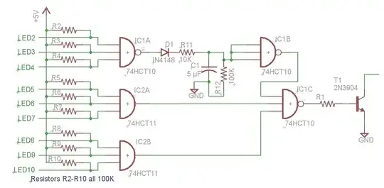

This can be easily done with some logic gates (2 IC's):
I am using NAND's and AND's instead of OR's because the outputs of the LM3914 are active low. I found from another answer that the outputs are open-drain, so I added 100K resistors to all the inputs.
All inputs on the left come from the outputs of the correspondingly named LM3914 outputs.
If all LED's are off, the output of all three gates on the left will be enabled (NAND gate IC1A low, AND gates IC2A and IC2B high), and the output of the NAND gate (IC2A) will be low, keeping the transistor off.
If any LED is on, the output of its corresponding NAND or AND gate will be disabled, and the output of the NAND gate IC1C will be high, turning on the transistor.
There is a special case for LED2-4, which will be blinking. I added a diode D1, two resistors R11 and R12, and a capacitor C1 to form what is essentially a retriggerable one-shot. While any of the inputs to IC1A are cycling on and off, it keeps the input to the IC1C low and its output high, keeping the transistor on. IC1B is being used as an inverter, since the gate was spare.
This shows a simulation of the timer circuit using Circuit Lab. The input to the inverter is kept above the minimum logic high-level of 2v while the input is toggling:
I have not shown the power connections or other pin numbers, but they are available from any datasheet for the parts. You could also use other logic families, such as CD4000.
I realize it really looks like I should be using an OR gate instead of an AND. As mentioned earlier, it is all because the outputs of the LM3914 are active low. It turns out an AND gate is equivalent to an OR gate that has both inverted inputs and output:
Follow the truth table through for each gate if you don't believe me. So the inverted outputs of the LM3914 match up perfectly with the inverted inputs of the "OR", and the inverted output of the "OR" matches up perfectly with the inputs of the next OR.

  • I agree with tcrosley. You need a 9-input OR gate. –  Oct 19 '14 at 23:05
  • Confused now due to above comment, would I need 9 pin AND or an OR? – klcjr89 Oct 20 '14 at 01:21
  • @troop231 AND gate. I included some additional explanation at the bottom of my answer why that is correct. – tcrosley Oct 20 '14 at 01:54
  • @tcrosley Thanks for the update. I'm a little confused where to wire the 3 legs of the AND gates to, before the LED, or after? Could you update the schematic? Thank you – klcjr89 Oct 20 '14 at 01:55
  • You wire the inputs of each AND gate directly to the outputs of the LM3914. That is why L labeled the leads the same as the output pin names. i.e. the first input to the top AND gate goes to pin 18 of the LM3914, etc. – tcrosley Oct 20 '14 at 01:59
  • @tcrosley, will there be a problem with my flashing LEDs 2,3,and 4 using your answer? – klcjr89 Oct 20 '14 at 02:00
  • @troop231 You added the comment about the blinking after I designed my circuit. What causes them to blink? I believe that will cause the transistor to turn on and off with the blinking, using my current circuit. I don't think any of the other answers address this either. – tcrosley Oct 20 '14 at 02:04
  • Actually, my original question shows the blinking circuit with the diodes on LED 2,3,4. Capacitor C1 as well. – klcjr89 Oct 20 '14 at 02:21
  • I understand it was in your original circuit, and Andy aka immediately asked how it worked. Thanks for the update in your question pointing to the other answer. I'll take a look at it. – tcrosley Oct 20 '14 at 02:39
  • @troop231 I updated the circuit with a timer circuit to take care of the blinking LEDs. You said in the other post you didn't want to use a 555 so I rolled my own. – tcrosley Oct 20 '14 at 06:25
  • @tcrosley, does what you added blink the LEDs, or is that just for the one-shot? – klcjr89 Oct 24 '14 at 14:42
  • @troop231 It keeps the transistor on during the blinking, i.e. without the extra circuitry the transistor would following the blinking of the LED on/off/on/off etc. See the blue line of the simulation, it does not drop all the way to ground, but remains high enough to keep the NAND gate on, and thus the transistor on. – tcrosley Oct 24 '14 at 15:28
