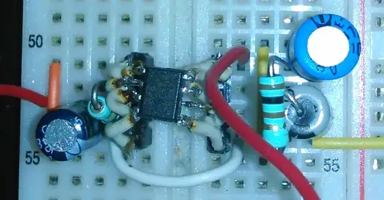

I actually did a quick test myself and used electrolytic capacitors everywhere. In total, the circuit drew about 110mA, while the 5V circuit drew only 2mA. And besides that, the output has about 0.4V AC noise. However, it's not entirely sure that this is just because of the capacitors, because I for example didn't use a very short trace between GND and PGND (pin 1 is top left):
So it really isn't possible. The question remains why.

I see three things that are hurting your charge pump circuit.
The capacitors are aluminum electrolytic instead of ceramic, so they have very high dissipation factor and low self-resonant frequency. These charge pumps really do require ceramic capacitors.
Second, they are radial-leaded and axial-leaded capacitors instead of surface-mount. That adds some series inductance, which tends to defeat the capacitance.
Third, the whole thing is built on a white solderless breadboard, which adds even more inductance. You'd be better off using a PCB breakout board (like a Surfboard) and solder capacitors with trimmed short leads, or better yet, surface-mount capacitors.
