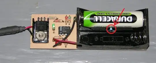

I did search the net quite a lot for an answer, but could not find anything about thermistor placement in battery chargers at all. I could only find placement of thermistor in circuit (the schematics). The only reference I found about its physical placement was this: Build a USB Powered AA NiMH and NiCd Battery Charger.
Picture of the battery charger
The completed charger with one cell in place. The 2-cell holder was made by cutting the outer positions off of a 4-cell holder. Notice how the thermistor is installed so as to make physical contact with the cells being charged. A small heatsink keeps Q1 cool.
The red marking is where I understand the thermistor was placed, which corresponds to Position C in my picture.
