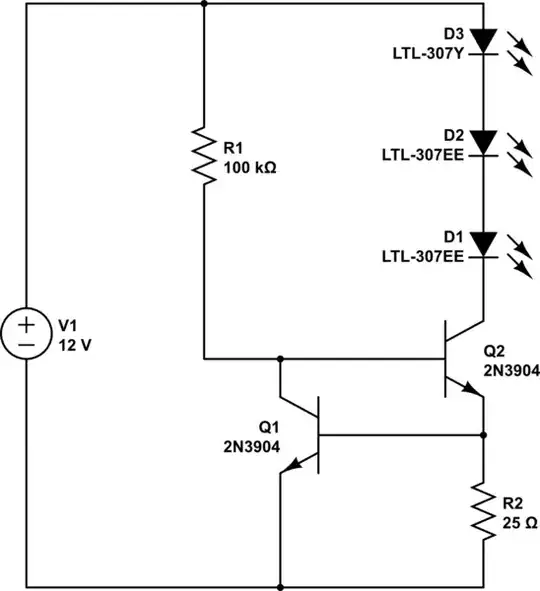

I need to drive 48 UV LEDs for UV paint curing system. (LED: 3.5V, 20mA)
I found a simple current source, modified it, set the current to 20mA. The voltage on 3 leds is 10.50V (3 x 3.5V, exactly what I need).
When I add another 3 LEDs in parallel to existing 3 (having 6 LEDs total), the current stays same but the voltage across each line drops slightly. When I finally have 18 LEDs (6 parallel lines), the current was still ~20mA but the voltage across each parallel line dropped to 9.5V. Somehow it must be okey for the LEDs because they did not lose their brightness.
My questions;
  • When I finally add all 48 LEDs current source will keep the current at 20mA and the voltage will drop more. Will that drop on the voltage be OK for the LEDs?
  • Adding new LEDs does not change the current drawn from the power source, so is safe to drive 48 LEDs with one single current source or it will burn down things (LEDs, transistor or power supply) in long run?

You may think the LEDs are the same brightness as you add more strings in parallel, but the 20mA is actually splitting itself between all of the parallel strings. So each time you add another string of parallel LEDs, the 20mA is getting split even more and the brightness of all of the LEDs is going down a little.
The relationship between current and apparent brightness of an LED is complicated. It's not actually linear, which is probably why you don't think the LEDs are getting any less dim. But I promise they are.
There's another complication as well. LEDs have a negative temperature coefficient. As they heat up, their forward voltage drops. Due to manufacturing variability, one string of LEDs will inevitably drop its forward voltage a little more than the others, which will cause it to grab a larger chunk of the 20mA, which will cause it to heat up more, which further decreases its forward voltage, and so on. The end result is that one string will tend to "steal" most of the available current and appear brighter. The easiest way to prevent that is to put a small resistor in series with each string. Regular resistors have a positive temperature coefficient (their resistance increases with temperature), so that works to balance out the current in each parallel strings.
If you truly want 20mA going through every LED correctly, you will need to decrease the value of R2 to an appropriate size. For example, two strings of LEDs will require 40mA of current. So R2 will need to be half the value. Four strings will require R2 to be one quarter the value. And so on.
By the way, the resistor value of R2 should be 35 Ohm, not 25 Ohm. I got this by taking the voltage that the base of Q1 will start to conduct (0.7V) and calculated the resistance that will result in 20mA at that voltage: $$\frac{0.7V}{20mA}=35 Ohm$$
Your equation for R2 based on the number of LED strings (to maintain 20mA for each string) is: $$R2=\frac{0.7}{n*20mA}$$ where n is the number of LED strings.

  • Now it makes a better sense, I was reading the current over R2 and I was missing split current between each string. The current on each string was less than 4mA with 6 strings. Quick question about small resistor on each string; does it matter how small the resistor is? For example can I use 1ohm to keep voltage drop on it lower? – dvdmn Oct 18 '14 at 03:04
  • You probably need something a little bigger because of the low current. Your best bet is to do trial and error. Maybe start with something around 10 Ohm and see how that looks. – Dan Laks Oct 18 '14 at 03:14
I assume you have a separate current source for each triplet of LEDs? In that case you should measure the voltage across your +12V source. Maybe it's dropping.
However, if you use the same current source for 2x3 LEDs and so on you have to adjust it to 40mA (adding 20mA per row), since they're in parallel. The current splits.
Keep in mind that LEDs don't behave the same as resistors. Half the current through one LED won't result in a 50% voltage drop. The loss in brightness could be subtle as well meaning, you simply don't see it but it is there.

If you want the same brightness for all the LEDs you have as in the original (3-LED) circuit, you'll have to let 20mA across each parallel string of your LEDs. To achieve that, you'll have to duplicate your circuit (R1, R2, Q1, Q2) for every string of LEDs. Simply connecting the parallel strings together, and increasing the total current (to a multiple of 20mA) is not a safe way to go, as the current will not be properly shared between the strings.
Or, instead of this moderately complicated circuit, you may use a simple series resistor (one resistor in series with each parallel string). If the voltage source provides a constant voltage then this will provide an acceptable solution.
