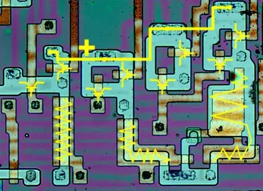

ChipWorks has an excellent blog about doing exactly this, with lots of great pictures here.
FlyLogic also has an excellent blog. It is here.
The short answer is it is absolutely possible. IC DIEs are basically really small circuit boards. You can reverse engineer them pretty easily, it just takes a different tool set.
I want to particularly call attention to some posts flylogic did on reverse-engineering ICs (how topical!) here and here.
Image borrowed from flylogic
Image from flylogic website

While reverse engineering of old microchips is feasible with an optical microscope and manual polishing, the challenge is to cleanly strip off layers. For instance, the above picture appears to be an older chip and from the color changes in the background you can see that it has been polished to remove a layer. Typical deprocessing processes involve polishing with specialized polishing/lapping machines or wet chemical etching with more or less dangerous chemicals.
However, for more recent chips the process sizes are so small that you will need sophisticated and more expensive equipment such as a plasma etcher, a Scanning Electron Microscope (SEM) or a Focused Ion Beam (FIB). Due to the complexity it is also no longer that easy to extract logic (i.e., the netlist information) from the chip. Today, companies thus use automated tools that typically process the obtained SEM images of chip layers to generate the netlist. The challenge here is deprocess the chip so that deprocessing artifacts are avoided as they would be problematic for any subsequent automated analysis.
