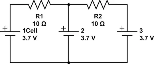

Now, if you put them parallel, please make sure you first balance them together with resistors for a while, like so:
In this drawing I am assuming you have ready-made packs that you don't want to take apart, but that do have a balancing wire. If there's no balancing wire: Take them apart and rebuild them! (Be careful not to damage cells! That will cause serious problems with potential bodily harm.) It's the only safe way! So you can use the above drawing with the balance wires. Then, when you've let that balance the cells through the resistors for several hours, connect the packs in parallel through the balancing wires, to get a pack like this:
simulate this circuit
If you have separate cells, or you have taken apart the battery packs to get separate cells, balance them in separate groups, so only the lower three together and only the upper three together. Like this:
Then solder them together without the resistors per group of parallel batteries, put them in series, add a balancing wire to the middle point of the finished pack.
Now, here's a very important thing to do: Make sure you have a way to balance-charge the finished pack! If you don't the lifetime of your batteries will be halved or worse! So after you have built the new pack, use a balance charger to fully charge both the cell stages before you start using it, or one of the two stages may get damaged very soon.

  • I have special lipo batteries from: http://www.dfrobot.com/index.php?route=product/product&product_id=489 that can be charged and balanced simply through a 9V/1A power adapter. Also the only wire that comes out of the battery is a 2.1 mm barrel jack. From what I understand(sorry if I mistook anything wrong from your response, im only a first year tron student), I can buy three of these battery packs and put them in an arragement like this: http://www.zbattery.com/c.288557/connecting_parallel.gif to put those three packs in parallel.Am I on the right track or did I miss something crucial? – Manan Oct 09 '14 at 17:21
  • I would charge each pack individually and make sure all these battery packs are at the same voltage before connecting them in parallel. Right? – Manan Oct 09 '14 at 17:40
  • @Manan Unfortunately that may not be possible. It depends on the electronics inside the battery pack. I cannot vouch for the electronics' reliability or ability to cope with connecting in parallel. Alternatively I cannot say if the pack will even allow you to draw a stall current at all, because the electronics inside probably will block off, so you'd need, IF it's possible at all, many more packs to support that. As I say in my answer: the only guaranteed safe way is connecting all cells together as drawn, not just the outside of the packs. – Asmyldof Oct 09 '14 at 19:48
