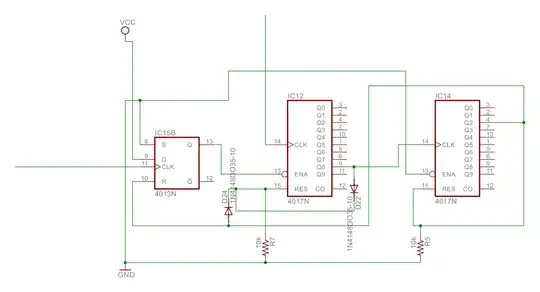

I've been prototyping a circuit for a first year university engineering project and I've been running into some problems with one section of the circuit that has really stumped me.
Basically the flip flop and the decade counters I have are sometimes powering on with random values, not their default ones. As I understand it, the flip flop should start with Q = LOW and the decade counters should have Q0 = HIGH, but this happens only occasionally. I've tried putting a capacitor on the reset line that comes out of the right counter, connecting it to VCC, but that seems to freeze up the counter for some reason.
I'm not too experienced with ICs, so I'm not sure if I'm perhaps damaging them or trying to draw too much current out of them by using diodes. I'm also not sure if the pull-down resistors I have are important to have, or if I should have them on every chip. If anyone could explain what I'm doing wrong, or what can cause random values on power on, that would be really helpful, because I am completely stumped.

    What are their default values and where did you get that information? – David Oct 05 '14 at 16:57
  • From the theory we've done in lectures, it always seemed that the flip flop would start with Q = LOW and notQ = HIGH and that Q0 = HIGH on the decade counters. I haven't explicitly seen anywhere that they start way, is assuming that incorrect? I did try putting a sort of reset capacitor in the circuit but it seemed to cause more issues. – Adam Oct 05 '14 at 17:10
    @adam This probably is just an assumption you get to make in the theory, because it makes further evaluation easier, but in the real world this state is only guaranteed by set or reset pins as described in the truth table. – Asmyldof Oct 05 '14 at 17:21
    There are no power supply decoupling caps in your circuit, did you add them in the physical device? 100nF, short leads to the power supply pins of each IC and each IC its own cap. – jippie Oct 05 '14 at 18:23
  • @jippie What do the decoupling caps do? We haven't learnt about them. Is it to prevent chip damage? – Adam Oct 06 '14 at 20:09
  • Many questions on that topic her on the stack: http://electronics.stackexchange.com/q/2272/8627 You also want to check the LINKED and RELATED questions listed in the rightmost column of that page. Basically: first thing to check whenever you have a(n intermittent) problem with a circuit, is if all chips have proper decoupling caps. – jippie Oct 06 '14 at 20:33

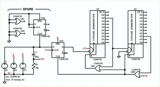

Your circuit needs to be started in a known state, and if the default is to be with the 4013's Q low and both 4017s' Q0s high, then to that end I've taken the liberty of redrawing your circuit, below, to include the Power-On-Reset using diodes to make it compatible with the rest of your diode logic.
Note that your R5 isn't needed since the diodes are being driven by a CMOS totem pole which never floats.
enter image description here Just for fun I've also added in some arbitrary clocks - to make it run - and, below, included a version of your circuit - with the same functionality but simplified by eliminating all the diodes and their associated resistors and replacing them with CD4071 OR gates. The LTspice files needed to play with the circuits or run simulations, if you want to, are here
