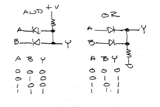

In the "AND" case, below, Y will only go true (high) if A AND B are true, while in the "OR" case, Y will go true when A OR B are true
