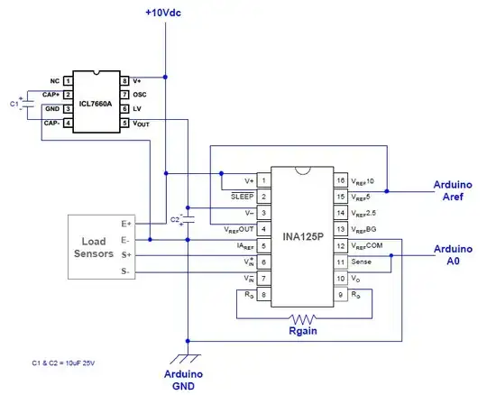

---- UPDATE ----
After some more digging I stumbled across a cheap voltage converter IC ( ICL7660A ) that I was hoping I could use in conjunction with two 10uF capacitors to create the negative 10V supply to the INA125P V- pin.
The documentation for the ICL7660A can be found here.
Is there any problem with using the ICL7660A to create the negative 10V as shown in my circuit below?
Could this cause any foreseeable issues with the INA125P or the rest of the circuit?
Negative 10V created by ICL7660A
--- UPDATE 2 ---
I ended up testing the above circuit and indeed it appears to supply the -10V to the V- pin of the INA125P, however it does not seem to improve the analog reading range... I am still getting readings between 300 - 1023. I was under the impression that by supplying a negative voltage to pin V- I would be able to get the full range 0 - 1023.
I am also contemplating adding a fixed 10V voltage regulator to the excitation voltage to see if that has a stabilising effect... does it matter where this is placed? I.e. close to the load cells or close to the voltage supply or is it irrelevant??

  • What do you mean by bouncing? – Andy aka Oct 02 '14 at 07:54
  • I mean that the analog reading keeps fluctuating and never seems to steady itself. Say for example I apply a load to the load cells and get an output of the analog reading to serial of around 305. It won't just sit on 305 but bounce around, for example 300,301,307,310,305 etc etc. It is even worse without my smoothing logic on the software side. – Tome A Oct 02 '14 at 19:36
  • What gain is your INA125 set for and how much gain is there afterwards? The booster is bound to create noise of course and most people would use an extremely stable excitation voltage. I don't consider this device as giving a problem on a single supply btw. What sampling rate are you using and do you have an anti alias filter before your ADC? – Andy aka Oct 02 '14 at 20:45
  • I am using a trimpot to set Rgain and did this by applying my max load of 40Kg to the load cell platform and slowly adjusting the trimpot until I got as good a reading of 1022 as possible. Measuring the resistance with my multimeter shows a reading of 72.4ohm which would give me a gain of 832.7 from a possible range of 4 - 10000 according to the formula provided in the INA125P doc. – Tome A Oct 02 '14 at 21:50
  • I bought the booster off ebay (XL6009 DC-DC Step UP Boost) and it seems to provide quite a stable 10V output. That said I am only using a standard multimeter to measure this. – Tome A Oct 02 '14 at 21:57
  • My code takes reads every 10ms (i have tried increasing this and observed no noticeable difference in stability). I am using a running median of 25 samples and then averaging the innermost 10 samples to get my reading and eliminate outliers. This is working quite well and without it the readings bounce ridiculously. I am using the Arduino's built in ADC, unless there is some anti-alias filter built in to it, I have nothing connected between the A0 and the INA125P. – Tome A Oct 02 '14 at 22:05
    Do the readings fluctuate the same with no load on the weigh plate? Have you tried using the same reference voltage as the excitation voltage - at least this way you make a ratiometric reading and rule out some errors. – Andy aka Oct 02 '14 at 22:38
  • The weigh plate itself obviously has a weight and with nothing on the plate the readings bounce from 304 to 306. With no plate and no load on the load cells the readings bounce from 226 to 228. – Tome A Oct 02 '14 at 22:58
  • Without the negative voltage supply I am only able to get an analog reading range of between 304 (no load other than the weighing platform itself - 0 Kg) and 1023 (40Kg). Which means I get 40,000g / 719 = about 56 grams per integer. – Tome A Oct 02 '14 at 23:07
  • Also, the limitation of the Arduino allows only for a max Vref of 5V. – Tome A Oct 03 '14 at 00:19
  • How did it go so far with your project. I did almost the same thing, but I used another AMP. Instead of the INA125P i used an AD620. But the thing which wonders me is that I gain non-linear data when measuring weight. Is there any reference voltage necessary, or do I need to set a negative voltage for the S- Signal wire that goes into the V-IN of the AD620 amp? –  Oct 31 '14 at 15:49
A few things to be aware of first: With only 10 bits your 1 bit resolution will be (Full Range)/1023, in this case 40kg/1023 = 0.0391kg (39.1g). The 1 bit noise level (39.1g) at the Arduino analog input is 5v/1023 = 4.89mv, (assuming a 5v Arduino system). At the amplifier input the 1 bit voltage value is further divided by the amplifier gain. So any system noise over these values will reduce your resolution further unless extra filtering is used. Also remember that the Arduino chip can be damaged if the A0 input goes below GND or over VCC. Protection diodes could help here if there is no other control.
The +10 and -10 supply setup only helps if needed by the amplifier chip, and/or if it brings the voltage across each load cell to the max 10v level, thereby giving the max output. But as above this could also lead to a negative voltage on A0. For example with a +- supply just lifting your system up by the weighing platform might send A0 negative. (If you do test for this be sure to disconnect A0 from the Arduino first.)
To filter the S+ and S- lines you could try placing low value series resistors onto each line then placing a parallel cap (non-polarized) across them, (with the cap nearer to the amplifier chip). 1k resistors and a 1uf cap might be good values to try. A same value series resistor and cap to GND on the A0 line may also help, (with the cap nearer the Arduino input). These filtering ideas might not help much if your system noise is already too high. The extra RC parts will reduce the response time slightly. If the slower response is unacceptable then a lot of digital filtering would be needed.
Check your zero point noise. Short S+ and S- and see if you get a stable reading near zero. (Do this first by disconnecting A0 and verify with a DVM that A0 does not go negative.) With A0 connected, any "bouncing" you see will likely be system noise from the amplifier or the Arduino. To reduce amplifier noise place larger value caps from the V+ pin to GND and from the V- pin to GND. (10uf to 47uf should do, observe correct polarity). A small cap (maybe 0.1uf) across the gain resistor might help, (check the amplifier's data sheet). To reduce Arduino noise be sure you are using the analog function that switches off the digital system before taking a reading. I don't know if the standard analogRead does this or not. Most of the Atmel chips have this capability. You may need to look up the library function and read through the Atmel chip data book.
To calibrate your system use a good resolution DVM. Temporarily disconnect the A0 input and connect it to the DVM +, with DVM - to GND (or E-). Place a full range mass (40kg) on the scale, adjust Rgain (add a small potentiometer if needed) until you get a reading very close to, but not over Vref. Next remove the 40kg mass and see if the voltage reading is very near 0v. If not near 0v you can give some voltage offset by adding a very high value potentiometer (100k to 1M) connected between E+ and E- with the center connected to a 100k then to S+ or S-. After adjusting the zero point retest and readjust Rgain if needed.
