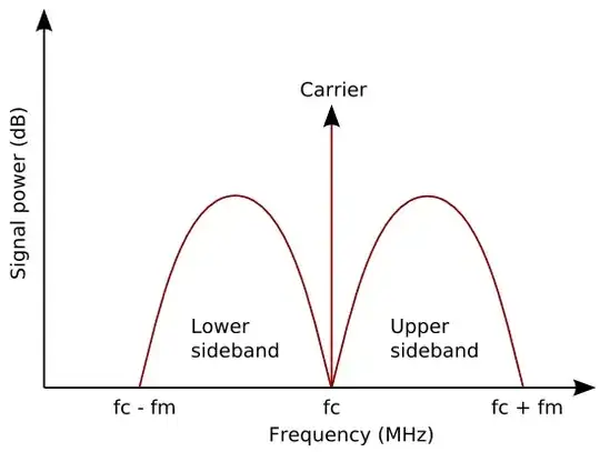

I think you're assuming that in AM the bandwidth of the signal is zero.
It is not.
Standard AM produces sidebands at the modulating frequency as follows (Wikipedia), where fc is the carrier frequency and fm is the bandwidth of the modulating frequency: enter image description here
