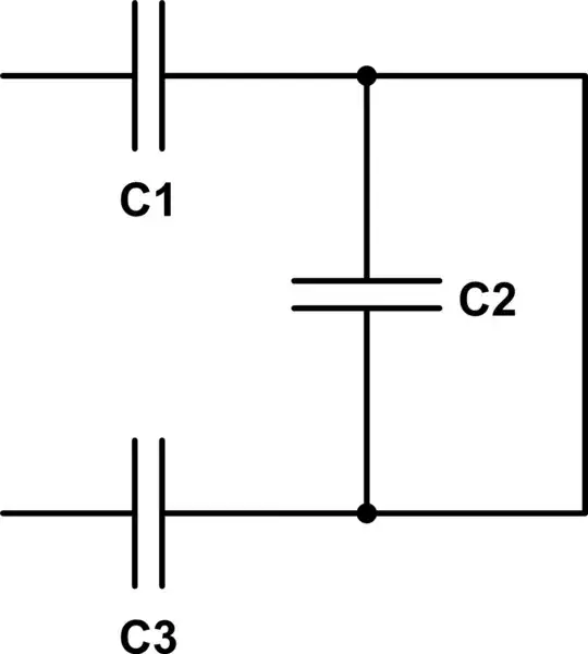

I have following circuit diagram:
There are three capacitors with equal capacitance \$C\$. As they are in series combination, the total capacitance should be \$C/3\$.
But my teacher said that the second capacitor (C2) is short circuited, so the output will be \$C/2\$.
My question is: why is C2 termed as short-circuited in this diagram?

  • It's short circuited because there is a wire between its terminals. But your initial analysis is wrong too - capacitance in series does not add, instead it reduces (capacitance and resistance behave oppositely in serial and parallel combination). – Chris Stratton Sep 30 '14 at 15:45
  • @ChrisStratton "It's short circuited because there is a wire between its terminals" but why?...I couldn't understand it. please explain in answer. – krupal Sep 30 '14 at 15:48
  • Those lines in your drawing are effectively wires. – Chris Stratton Sep 30 '14 at 15:48
  • @ChrisStratton sorry, but I don't know why wired lines show short-circuit? – krupal Sep 30 '14 at 15:50
  • To get the concept using resistor [Why shorted resistor is ignorable?](http://electronics.stackexchange.com/questions/126903/why-shorted-resistor-is-ignorable/126907#126907) – Amit Hasan Sep 30 '14 at 15:57
    @krupal because that is the definition of "short circuit". A component "is short-circuited"/"is shorted"/"has a short circuit across its terminals" if there is a wire that directly connects both terminals (and plain lines in the diagram represent wires, as you probably already know). – user253751 Oct 01 '14 at 03:08
    "Short" is slang for "zero ohm resistance". Even if the wire is longer than the part it is bypassing, it's still called "a short". – gbarry Oct 01 '14 at 04:29

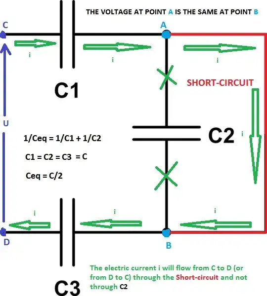

The short-circuit in red puts the 2 points A and B at the same voltage, bypassing the capacitor C2.
short circuit

Any element for which terminals are connected by a conductor, as the capacitor in the figure, is said to be shorted.
By having their shorted terminals, the voltage thereof is zero (more precisely, the potential difference between them), so that this element is not operational in the circuit, and can be removed for analysis.
The other two capacitors are in series, hence that:
$$ C_{eq} = \dfrac{C}{2} $$
provided that the capacitors are the same value.
Another correction:
As they are in series combination, the total capacitance should be 3C.
If they were in series, the capacity would be:
$$ C_{eq} = \dfrac{C}{3} $$
Take a look a this previous answer.

From your question: "Why is C2 termed as short-circuited in this diagram?"
it seems you are asking "What in this diagram indicates that C2 is short-circuited?"
But in your comment: "... but why?...I couldn't understand it.", it seems you could be saying:
"I (now) understand that it is short-circuited, but why is it short-circuited?"
as in, it makes no sense to short-circuit the capacitor, so why is it drawn this way?
If you are actually asking why as in "why is it drawn this way (short-circuited)?", then the answer most likely is that it was drawn that way to provide an example of a shorted capacitor in a circuit for the purpose of introducing the concept.
In "real life", a circuit diagram would not normally include a permanent wire connecting both ends of a capacitor.

A short circuit here means that there is no resistance (impedance) between the two terminals of the shorted capacitor. The vertical wire drawn next to the vertical capacitor shorts the two terminals of the capacitor. Any current flowing through this circuit segment will flow through the vertical wire and completely bypass the vertical capacitor due to the short. This means you can ignore the shorted capacitor -- it has no effect on the circuit.
The two remaining capacitors are in series because they have one terminal each connected directly to each other by a wire. If they were in parallel then both terminals would be connected directly to each other by wires (i.e. they would be in parallel if you connected the two vertical wires on the left).
Also, the equivalent capacitance \$C_{eq}\$ of \$n\$ capacitors \$C_{1}\$, \$C_{2}\$, \$\ldots C_{n}\$ in series is
$$\frac{1}{C_{eq}} = \sum_{i = 1}^{n}\frac{1}{C_{i}}$$
Since all the capacitors have capacitance \$C\$ and one is shorted here the equivalent capacitance is
$$C_{eq} = \frac{C}{2}$$
