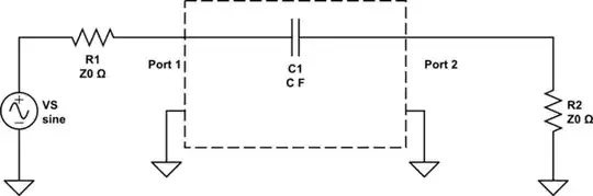

ThePhoton has given a very good answer. However, below is an expanded version with complete derivation of the formula and check in LTSpice, as well as power transfer analysis.
I. The S-matrix for the 2-port system is
$$\begin{pmatrix} {\frac{Z}{{2{Z_0} + Z}}}&{\frac{{2{Z_0}}}{{2{Z_0} + Z}}}\\ {\frac{{2{Z_0}}}{{2{Z_0} + Z}}}&{\frac{Z}{{2{Z_0} + Z}}} \end{pmatrix},$$
where \$Z \equiv {1 \over {j\omega C}}\$, \${Z_0}\$ is the real characteristic impedance of the system. The matrix is true for any Z, both with resistive and reactive components.

IV. Extraction of s-parameters in LTSpice and check of the analytical formula
Finally, let's extract an s-parameter with LTSpice and compare it with our analytical formula. Let's do it for, say, \${S_{21}}\$:
$$\left| {{S_{21}}} \right| = \left| {{{2{Z_0}} \over {2{Z_0} + Z}}} \right| = {{2{Z_0}} \over {\sqrt {4Z_0^2 + {1 \over {{C^2}{\omega ^2}}}} }} = 0.30,\,$$
at \${Z_{0}}\$=50 Ohm, \$\omega\$=10 MHz and C=50 pF.
Extraction in LTSpice:

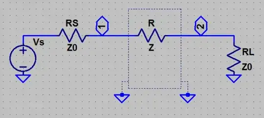

When calculating the S-parameters, you should terminate all of the ports that don't have stimulus applied. So, in your situation, to calculate \$S_{11}\$ and \$S_{21}\$, you'd be working with this circuit:
Notice that the current passing through the capacitor from port 1 to port 2 is \$i_1\$ and \$-i_2\$ at the same time.
Now you can easily calculate \$i_1\$ and \$i_2\$ using the series impedance rule:
$$i_1 = -i_2 = \frac{v_s}{2Z_0+1/j\omega{}C}$$
And you can also calculate \$v_1\$ and \$v_2\$ using the voltage divider rule,
$$v_1 = \frac{Z_0+1/j\omega{}C}{2Z_0+1/j\omega{}C}v_s$$
$$v_2 = \frac{Z_0}{2Z_0+1/j\omega{}C}v_s$$
