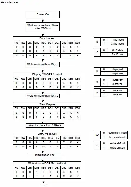

Yet after all of this, I can't get anything to display on the LCD! So here are my questions:
  1. The manufacturer has verified that there is a bug in the NT7605 where the busy bit isn't asserted properly. So I have been using fixed delays (fine with me), but wanted to use the busy flag to see if the driver is even responding to commands. Is there another way for me to do a low-level diagnostic to see what the LCD is thinking as I send initialization commands?
  2. Has anyone else here used the same LCD? All other standard LCDs I've used (2x20 character types) darken noticeably when I turn the contrast adjustment, and IIRC they do this even when not initialized properly. However, when I turn the pot on mine, the LCD doesn't darken at all. Perhaps this is because it's not initialized, but I'm not sure.
  3. Can anyone find something screwy with this initialization routine?
    1. delay > 30ms
    2. send 0x20, upper nibble only
    3. send 0x28 (set 4 bit interface)
    4. wait 10ms
    5. send 0x0C (display on, cursor off, blink off)
    6. wait 10ms
    7. send 0x01 (clear display)
    8. wait 10ms
    9. send 0x02 (increment cursor, no display shift)
    10. wait 10ms
    11. set RS high to start sending character data
    12. send 0x48 (display 'H')
Initialization routine from the manufacturer
My code looks like this:

The only thing I can say is that the LCD looks like it flickers when I step over SendLcdByte and am sending it character data. When I scope everything, it sure looks like I'm flipping bits properly...
EDIT -- I soldered up a new LCD, and this time I tried leaving the unused data pins (D0-D3) disconnected (i.e. floating). There was no difference. The LCD still flickers when I initialize. I am now waiting 100ms for all delays, including a delay when strobing E. I have also disconnected Vcc coming from the Launchpad FET section and am now just powering the MSP430 and LCD from my lab power supply.
EDIT #2 -- I went to a 3.3V LCD and everything magically started working. Thanks to ToyBuilder for catching a stupid code bug when I was debugging with the 5V LCD. After the swap the LCD initialized properly. I'm currently displaying garbage instead of "Hello", but that's unrelated to this question.
EDIT #3 -- found my display bug -- I was sending 0x06 for entry mode instead of 0x02. Not sure why I did that, must have been a typo.
Dave

Oh, duh, I didn't read your code carefully -- your send SendLcdByte is wrong:
    void SendLcdByte( unsigned char command_0_or_data_1, unsigned char command)
    SendLcdUpperNibble( command_0_or_data_1, command);
    // send the lower nibble next
 // AS WRITTEN:
    P1OUT = (command & 0x0F) | (P1OUT & 0xF0);
 // SHOULD BE:
    P1OUT = ((command & 0x0F) << 4) | (P1OUT & 0xF0);
    Strobe( command_0_or_data_1);
Toybuilder
