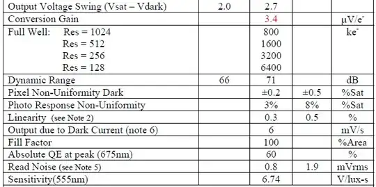

One problem is that different manufacturers provide different information/specs for their product, so it is difficult to compare them and choose the best one for application. I took one example and tried to calculate it's minimum amount that must reach the pixel before it can be detected. Please, correct me if I am wrong:
  • I use "Output due to dark current" and "Conversion Gain" values to determine how many electrons converted from light are needed to reach the threshold above which they will become "detected": 6mV/3.4uV/e = 1765 electrons.
  • I find conversion efficiency at a desired wavelength (let it be 700nm): Given that the QE(675nm) is 60%, I find that at the 700nm QE=60% * 0.87 = 52.2%
  • Thus, the minimum amount of photons that must strike the pixel before they become detected is 1765e/.522e/ph= 3381 photons
Now, I wish to compare this sensor to S11639, however, there is not information to calculate the number of photons as in the first example: - The amount of electrons needed is: 0.4mV/25uV/e= 16 electrons! That is 110x less than for the first sensor. Now, there is no QE plot for this sensor. The only thing I can do is assume that at 700nm it has a low QE value, say 20%. But even with this bad QE value the number of photons needed to reach detectable range is 16e/.2e/ph= 80 photons - muuuch less than in the first case. Thus is it right to assume that the second sensor is much more suitable for my application with very low light intensities and exposure times because it needs less photons to reach the detection threshold? Are my calculations correct? Anything that I am missing?

For your conditions what is the most important factors will be NEE (Noise Equivalent Exposure, QE = Quantum efficiency).
The ratio \$\dfrac{SEE}{NEE}\$ is your Dynamic Range (DR) where SEE = saturation Equivalent Exposure.
You need to understand what is meant by exposure, this is the integral of the photon flux over time. In other words the # of photons collected in a time period.
Unfortunately, most sensor manufacturers Quote NEE and SEE in electrons (after the conversion of Photons to carriers - here electrons) rather than actual photons so you will need to bring in the QE to calculate the actual light levels. These numbers are often implied with a saturation level being quoted, in that case the QE is implied.
In your low light high speed application you need a sensor with as small a NEE as possible, and you will need to see in the data-sheet some mention of CDS (Correlated Double Sampling) or kTC noise removal.
After update with datasheet: *****
Using nominal Vsat with conversion gain:
\$FW = \dfrac{V_{sat}}{G_{conversion}}=\dfrac{2.7}{3.4*10^{-6}} [\dfrac{V}{\dfrac{V}{e^{-}}}] = 274,118 [e^{-}]\$ FW= Full Well
This is close enough to the 800 \$ke^{-}\$ in the data-sheet. SO the SEE = 800 \$ke^{-}\$.
Dynamic range is 71 dB which is 3548:1.
\$ NEE = \dfrac{800,000}{3548}=225 [e^-]\$
Using your dark current calculation of 1765 electrons being generated in 1 second, the noise associated with that is:
\$ \sqrt{1765} = 42 [e^-] \$
Ideally the dark current contributes a variable baseline with temperature and the noise associated with that baseline shift is the shot noise of the leakage current.
The dark shot noise and the amplifier noise being independent of each other add in quadrature:
\$ Noise_{total} = \sqrt{225^2 + 42^2} = 229[e^-]\$
Using your QE calculation from above, the NEE is \$ \dfrac{229}{0.522} = 439 \gamma\$
You can do the same with the Hamamatsu S11639.
However, you still cannot directly compare the two because you have omitted an very important datapoint. What is the area of a pixel?
What is important is that to compare these two sensors in the same conditions. You need to understand the irradiance required to meet NEE, which has units of \$\dfrac[W][m^2]\$ but \$\dfrac{\gamma}{m^2}\$ is comparable if you are using a single wavelength. Here \$\gamma\$ means photons.
Your next step in the comparison is look at the optical setup, f/#, resolution etc.

  • Yep, that makes sense. However, I thought that all the info in the datasheet is given for a single/average pixel of a given sensor. Thus, if I wanted to keep the resolution constant (assuming they both have same # of pixels), I would only zoom in/out the image to cover the entire sensor. This would not change the amount of photons that strike each pixel, regardless of the pixel size. So, in this case, there is no need to compare pixel sizes, is that right? – Nazar Sep 29 '14 at 14:00
  • That is very astute! Most people say that the bigger the pixel the lower the noise because of increased photons ... etc. etc. But if you change the focal length of the lens to match the field to view to the image plane then the photon irradiance should stay the same ... AS LONG AS you keep the same f/# and you don't run into NA issue in the pixels. But to a first approximation that is right. – placeholder Sep 29 '14 at 14:50
  • Nice. +1 more word to my vocabulary. Speaking of the Hamamatsu sensor... I calculate FW=2V/25uV/e=80ke. I also get number of dark electrons generated as 0.4mV/10ms * 100 = 40mV/s / 25uV/e = 1600 e/s; whereas the noise is 40 electrons. But how do I calculate the amplifier noise? The specksheet gives me two dynamic ranges, which one do I use? – Nazar Sep 29 '14 at 15:34
  • readout noise is 1.0 mV/ 0.025 = 40 electrons. 80Ke/40 = 2000:1 the Vd based measure is meaningless, no point in putting that in the datasheet. Withe your dark current calculation (which is correct) that is sure some leaky PD. – placeholder Sep 30 '14 at 05:01
  • So, for conclusion, the first sensor (according to your calculations) needs 439 photons before it starts "seeing" the light, whereas the second 40e for dark current, 40e for amplifier noise, which makes sqrt(40^2 + 40^2)=57e total noise. Given QE of about 60%, the second sensor needs 57/.6=95 photons, before it sees anything. Therefore, I conclude that the second one is more sensitive. Regarding "leaky": with 200us exposure I get 0.4mV/50/25V/e = 0.4e, which is 0.6e dark current noise. Just wanted to confirm that my reasoning is right. – Nazar Sep 30 '14 at 13:45
