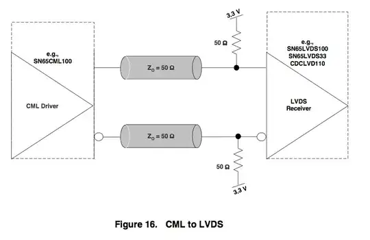

TMDS uses CML (Current Mode Logic) that is terminated to Vcc at the receiving end. LVDS from the standard (IEEE644) is a voltage mode driver that is terminated across the pairs also at the receiving end. But it's not as simple as that, as LVDS drivers often control slew rate on transitions to prevent ringing and other nasty effects, and during this mode the driver acts more like a current source.
However, on a strict reading these two standards are different and incompatible. the encoding scheme on top of this physical layer (8b/10b DDR etc.) are logical operations.
There are translator chips (one from TI is SN65CML100) so you could add that to the board. Interestingly this chip can also be a CML to CML bridge, so there is probably some good reading from that data-sheet that will get you further along in your understanding.
Interestingly, this datasheet (warning opens as pdf) says that capacitor coupled LVDS can drive CML inputs. page 14 " An ac-coupled LVDS driver is often useful as a CML driver."
Given that you are looking at receiving TDMS into a DVI input, it's possible it will work. Ideally you'd terminate the pair to Vcc but the LVDS will probably have a termination cross phase built into the device that can't be removed. So that is a complication as the termination will be the wrong value and you'll have a resistor divider on your input.
And finally, here is a link to an app note from Ti (again another pdf) and it meantions the termination above. but there is a note:
Generally, ac-coupling is recommended when driving LVDS receiver with CML. If the LVDS receiver has a wide common-mode range that can accept a CML input (common-mode range must go to VCC rail), then a dc-coupled connection is a direct connection.
so the common mode range of the LVDS receiver is important. They also don't show internal termination, which may be an issue for an FPGA. Here is the snipped picture from that app note.
If the LVDS input accommodates multiple voltage swing ranges then you might be lucky. Some "LVDS" operate on only 500 mV swing for example.
