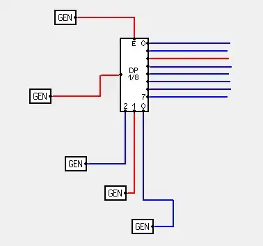

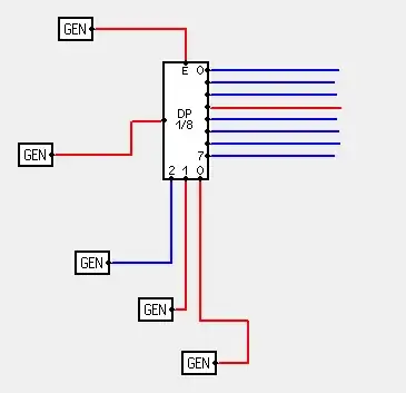

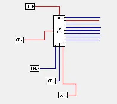

Here's a picture of a demultiplexer. The GEN on the left is input signal. The GEN on the top controls if the multiplexer is on or off. In a real world project, you'd do this using power connectors. The 3 GENs on the bottom control address pins and on the right are output signals. When the address lines are low, output number 0 is selected.
pin 0
Here we have pin 1 selected:
pin 1
Here we have pin 2 selected:
pin 2
