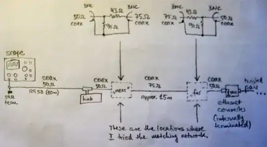

I was still curious if the hack I had done was really bad (as in: just barely good enough) or maybe even quite acceptable. I looked at the signal with an oscilloscope. The setup is like this: Setup

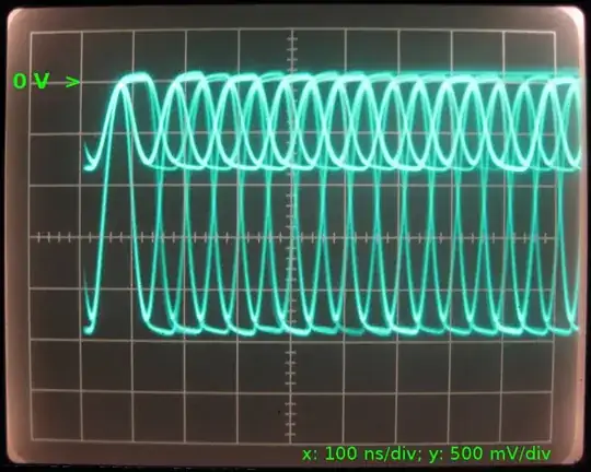

Without any matching between the 50 Ω and 75 Ω segments of the coax, the result shows a very obvious amount of reflected noise. Despite this drawback, the "eye" is still wide open, and the decoders can happily do their job, resulting in a packet loss of exactly zero. No matching network at either end. We're looking at a combination of the signals transmitted and received by the ethernet hub near the oscilloscope. Judging by the "clean" part, the transmitted signal has approx. 1.9 Vpkpk, and the received signal has 1.6 Vpkpk. If it's safe to assume that both drivers have an output of the same amplitude, we can even calculate the loss introduced by the cable: 20×log(1.6/1.9)dB = 1.5 dB. Good enough, because the calculation for 15 m of typical coax with 6.6 dB/100 m yields 1 dB.
The noise is greatly reduced when a matching network is inserted at the near or far ends of the 75 Ω part of the coax. It looks like this (Credits to this source)... Matching_Network

And, for your 50/75 ohm setup will be -0.2. So the signal you put down the cable of (say) 3Vp-p will produce a reflection of 0.6Vp-p. Is this too much? It's not great but it's certainly not terrible.
  • Heh. I certainly enjoy how well your calculated 0.6Vp-p match the reflections in my first oscillogram. Theory proven. Please excuse, however, that I have added my own answer. The reason has to do with the way 10base2 handles collision detection. After my setup has been in service for more than two years with and without the resistive matching network, I can now report that the reflections are not an issue, but the filtered currents across the termination resistors are. My "backbone" (haha. backbone! 10Mbit!) works completely fine without the matching network. With the network, just sometimes. – zebonaut Jan 19 '17 at 12:21
