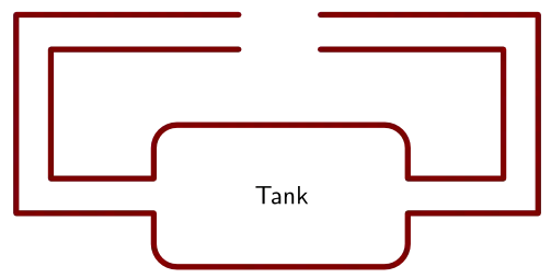

Imagine this:
For electricity, the pipe heals itself. The wall thickness is the distance to the nearest other conductor. It may seem kinda weird to think of moving things through a solid pipe wall like a wire through air, but if you ignore that part of physics, the analogy works.
If the "wall" is too thin to hold the pressure, it punches through, which we call an arc. This works at very small scales too, like a 5V chip arcing internally when powered with 12V.
