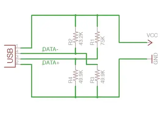

I am not sure if this answer will solve your question, but Apple does a similar thing with their wall chargers to make sure that the devices are not being charged too quickly. To accomplish this, the chargers have a voltage divider circuit comprised of 2 resistors that gives a reference voltage to one or both of the data pins. Inside the iPhone, there is additional circuitry that reads the voltage on the data pins from the voltage divider.
Here is a diagram of an "Apple Compatible" charger featuring the voltage divider that I was talking about:
Apple Compatible Charger
I would assume that Apple has different voltage dividers for different rated chargers. This way, a phone can tell if it can safely charge itself if the reference voltage is under 2v for example.

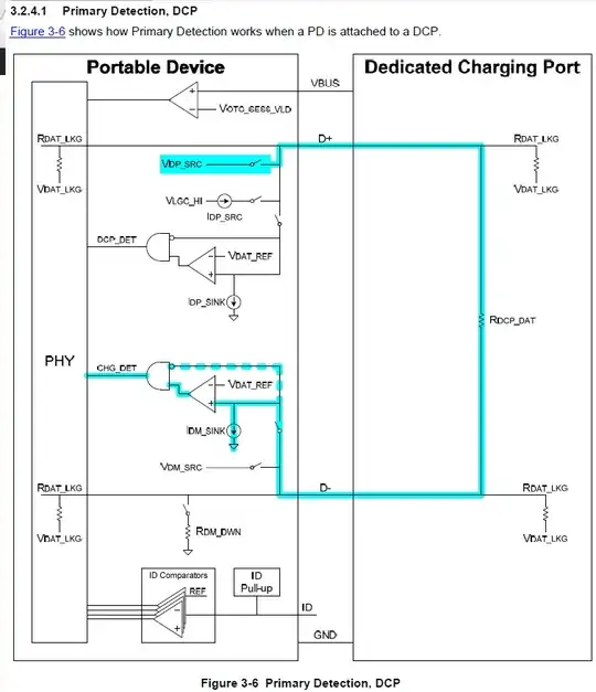

I guess it's possible the charger is implementing data contact detection (to ensure full insertion- the power contacts mate first).. suggest you try connecting the D+ to a plausible VDP_SRC voltage.
