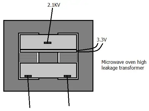

It is an inverter type. The transformer will not work on the mains. It needs a much higher frequency and the current needs to be controlled, using pulse width modulation, which is done by the control circuit. The magnetron acts like a 4000V zener and needs to be run off a current source or high impedance source. According to the diagram, there is a small extra secondary on the transformer to generate the 3.3V for the filament, which is also the cathode (known as a directly heated cathode). The 2 inductors block any RF coming out through the cathode. In one magnetron, they appeared to be tuned, as the turns were separated, which leads me to believe that they may have a second purpose: to smooth the cathode current & improve efficiency by preventing current surges as the spoked electron cloud inside switched from 1 set of vanes (which are now negative, to the next ones, which are positive). They have nothing to do with generating the 3.3V, which is between the lugs. Click on the address below to see how the magnetron works. You can use a mains frequency transformer from another microwave. The mains frequency circuit has a high leakage transformer which has magnetic shunts with air gaps, between the primary & secondary, so some of the flux can leak across the gap, bypassing the secondary, making it act like it has an inductor in series. This gives it a high impedance output so it can accommodate the square wave across the magnetron. The capacitor will have an odd looking value like 1.19uF. As well as forming a voltage doubler with the diode, it is designed to resonate with the secondary to bring the voltage back up, while retaining the high impedance. Magnetron Working Principle
  • Source of diagram: my own experiments. – Peter R. McMahon Sep 16 '20 at 03:10
  • Could you explain more about the *High Leakage transformer* ? – EJE Sep 01 '22 at 18:21
  • @EJE The high leakage transformer has magnetic shunts (laminated steel blocks) between the center part of the core and the outer parts, with an air gap, and are placed between the primary and secondary. With no load, the flux takes the easier path through the secondary. But when loaded, the secondary current opposes the changes in the flux, and tries to average it out to zero. The primary would normally force it through, but, with the shunts, the flux is able to bypass the secondary via the air gaps, allowing the secondary voltage to drop under load like there is an inductor in series. – Peter R. McMahon Sep 10 '22 at 06:44
  • Thank you for the clarification. I agree with @Transistor comments, as the Image should be used as a ‘Supplement’ on this original answer, including some textual clarification as you provided. Few curiosities, probably of no major magnetic significance: Transformer’s main magnetic core is vertically laminated. The magnetic shunts were represented as horizontal lamination. (1) Was is just a graphic representation or it really happens? (2) Being somehow ‘loose’ in that gap, don’t they move? Or both shunt halves are interconnected (then being horizontal laminated makes more sense)? Thanks again. – EJE Sep 10 '22 at 12:52
    @EJE That is how it is constructed. The magnetic shunts are slid in from the front or back, with insulation packed around them. If they were stacked the same way as the core, they would have to be glued together before inserting. As long as the flux goes along the laminations, it doesn't matter how they are stacked. They are not interconnected, just held in place by the insulation, and maybe, varnish as well. The air gaps can be on the inside, outside, or a bit of both. Electric arc welders used the same type of transformer, but with shunts that are wound in or out, to adjust the current. – Peter R. McMahon Sep 12 '22 at 07:38
