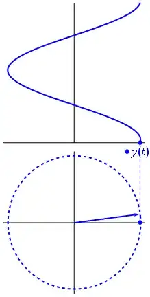

A voltage can be represented by a vector centered on the origin, its length being equal to the voltage value, its starting angle being equal to the phase. Now the magic trick: start rotating the vector so that its angular speed \$\omega\$ corresponds to the desired frequency:
Bam. That's what we call a phasor, and that little guy is the strongest weapon you have against tough circuits.

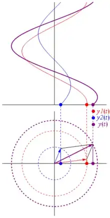

So why are these phasors special? That's because if you take two real voltages: $$ v_1(t)=V_1\cos(2\pi f_0t+\theta_1)\\ v_2(t)=V_2\cos(2\pi f_0t+\theta_2) $$ and you want to sum them, it happens that if you sum the corresponding phasors and then get back in the real domain the result is the same. This is not magic of course, it depends on the mathematics affinity between cosinusoids and the complex exponential. Just believe me, or believe this cool picture:
