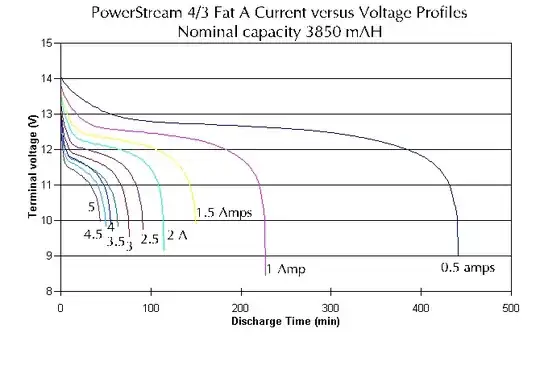

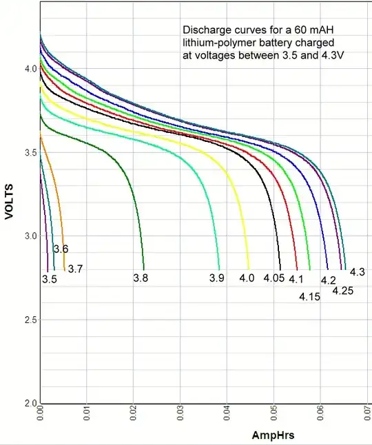

Textbook ideal voltage sources are just an idealization. Real batteries are not the ideal voltage sources. Battery voltage gradually decreases as the battery is getting discharged.
enter image description here (source)
P.S. A very good web site on battery subjects is http://batteryuniversity.com
