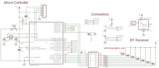

Below are the board schematics and design.
Car electronics schematics
Car electronics board

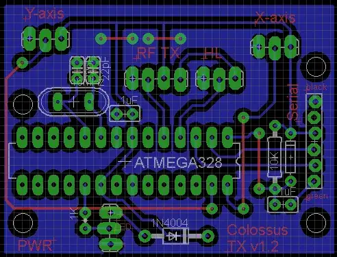

The controller schematics and board design are below.
Controller schematic
Controller board
