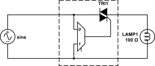

The simple answer is that the switches' electronics are in parallel with the load, which it controls via a SSR or triac, solid state devices, instead of a mechanical relay.
It is in parallel because these switches normally require the neutral wire be connected, and typical house wiring has both wires going to the light switch box, then run to the light fixture.

  • How can it be in parallel when neutral conductor is not connected? – venny Sep 07 '14 at 08:07
  • @venny yes, that question popped into my mind, too. – Ekrem Doğan Sep 07 '14 at 08:17
  • @Passerby What you suggest requires an additional third wire in the wall. In the case I ask, there are only two wires. Please check [this](http://i.imgur.com/jKNRM2T.jpg) picture from my home. – Ekrem Doğan Sep 07 '14 at 10:06
  • @EkremDoğan this is how a standard light fixture should be wired, imho http://www.diyhowto.co.uk/images/projects/light_sw2.jpgIt's technically a single cable, cut in the middle. Apparently, wiring to the fixture, then having a single cable run to the switch is somewhat common, but that seems wrong to me. – Passerby Sep 07 '14 at 18:00
