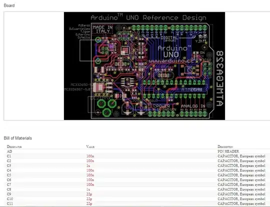

Here is an example: Arduino BOM
That is from this site (if you want to see the whole thing): Arduino Uno at SOLDERPad.

    I'd expect much more on a BOM. This one does not list stuff like component package sizes. If I asked someone for a BOM, I'd expect something that will let me build an order containing components sufficient to populate a part, and this doesn't do that. – Scott Seidman Sep 04 '14 at 14:49
    It is like someone asking you to give them a car. Here. Here is a car. Wrong car? This is, in fact, a BOM. There are many styles and needs, but this is a BOM. – Enemy Of the State Machine Sep 04 '14 at 14:54
    But that is more like a broken car. I know - one did not ask for a working car, but... I would expect to have enough information in a BOM that I could go away and actually build the final assembly. That means the information on the parts has to be good enough to identify them (manufacturer parts number or at least package, type of capacitor...). Which isn't the case in this example... – og1L Sep 04 '14 at 15:11
    Yes, its the type of BOM an inexperienced person would provide-- once. – Scott Seidman Sep 04 '14 at 17:43
    A proper BOM is something you can give to a turnkey manufacturer and not have them get back to you with part questions. – Olin Lathrop Sep 04 '14 at 17:59
