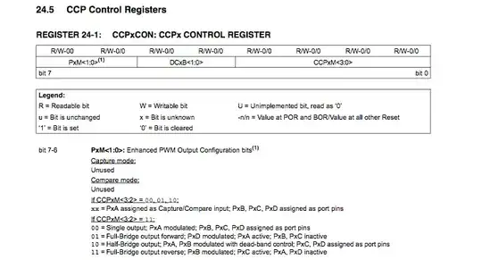

One possibility is that I'm misunderstanding which port pin is connected to the capture mode, but according to the datasheet (pic below) this should be pin P1A (aka pin 0, port B) since bits 3 and 2 of CCPxM are 01 (necessary to configure CCP to capture mode).
PIC16LF1827 CCPCON section of datasheet
