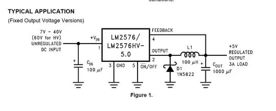

That's pretty fat wire. If it won't fit then you'll have to consider using a higher voltage and putting a regulator at the far end of the cable. A simple adapter alone won't do it unless you have fat wire.
For example, you could use a 12VDC adapter at the far end and an LM2576-based switching regulator to reduce that to 5.0V. Note that if the regulator fails 'on', the camera would likely be destroyed. You may be able to find a module based on such a regulator on eBay etc.
