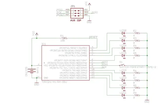

I have an ATtiny84 connected to my bench power supply set for 3 volts. It's fused for the internal 8 MHz RC oscillator and a divide-by-8 clock. No watchdog, no brown-out detector.
8 of the I/O pins are hooked to LED anodes, with the cathodes grounded through 0 ohm resistors (yes, the duty cycle is low. Fear not). One of them is connected to a button with the other side grounded. Two of them (shared with MOSI and SCK of the ISP) are not connected (other than to the ISP which is itself disconnected for this test).

The schematic:
For this test, the battery is absent and 3.00 volts is being fed in to the Vcc and GND pins of the ISP header. No other ISP pins are connected.
