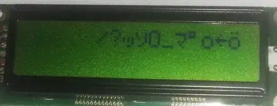

I've been trying to interface with a HD44780 compatible display (16x2) for quite a few hours now, but have run into some weird behavior problems which I can't solve.
My setup:
  • I'm using the LCD in 4-bit mode (the upper four bits, D4-D7, as in all the guides I've found, the order is correct - I've checked a few times).
  • The LCD is running from a 5v regulated supply. (I've tried 3.3v, same result, less contrast)
  • The R/W line is grounded with a pull-down resistor (fixed in write mode).
  • The contrast is set by a pot and I can get the one line of squares visible at startup.
  • I'm using very slow timings (~200ms wait - enable high - ~200ms - change data - ~200ms - enable low)
My init sequence:
(with RS low)
  • 0x03 - (three times) (sent as one nibble/byte)
  • 0x02 - Enable four bit mode (sent as one nibble/byte)
  • 0x28 - Function set (2 line, 4 bit) (sent as two nibbles, ms nibble first)
  • 0x01 - Clear (sent as two nibbles)
  • 0x06 - Set entry mode (increment cursor on write, no display shift) (sent as two nibbles)
  • 0x08 - Display, cursor and blink off (sent as two nibbles)
  • 0x0F - Display, cursor and blink on (sent as two nibbles)
Here, some things don't happen as expected:
  • Two line mode doesn't seem to enable (no dark background squares on second line, no chars get written there)
  • Clear doesn't happen
  • The cursor is in the 3rd square instead of the first at the end of this init sequence
Next I try to write some characters with RS high, sending 2 nibbles per character.
Here too, I get weird behavior: Instead of writing 1 character per 2 nibbles, it writes 2 (one per nibble). I made it go through the chars 0-15 and I get random symbols (eg slash) and Japanese chars. All of them are from random places on the char table, mostly the bottom row, not in any normal order, but always the same chars in the same order get printed.
My question: I've really run out of ideas to fix this. Am I missing anything obvious? What problems could I be having and how can I debug further?
Edit: This is what I see on my screen after init, it may be helpful LCD after init
Edit 2:

  • Do you have a sufficiently long wait before starting to write? And what value is the "pull down" resistor? – Spehro Pefhany Aug 20 '14 at 17:18
  • Did you follow the timing in the datasheet? – Ignacio Vazquez-Abrams Aug 20 '14 at 17:18
  • Sphero: The resistor is 1k – tehwalris Aug 20 '14 at 17:21
  • Ignacio: I don't have a datasheet for my particular LCD, but the delays I'm using are well over the max times specified in the HD44780 datasheet. Like I said in the question, I spend around ~200ms with enable high, ~200ms while data is written and ~200ms after the falling edge of enable. – tehwalris Aug 20 '14 at 17:23
  • Are you sure that the first three 0x03 do not enable 8-bit mode? In [datasheet](http://pdf1.alldatasheet.com/datasheet-pdf/view/63673/HITACHI/HD44780/+435JWUEGSzDpKdlpzC.hv+/datasheet.pdf) there seems to be some ambiguity between pages 42 and 46. – venny Aug 20 '14 at 18:10
  • [This datasheet](http://www.gme.cz/img/cache/doc/513/113/dem16217syh-datasheet-1.pdf) has nice flowchart on page 14 (labeled as 12), and it says only 0x02 0x02 0x08 is needed. – venny Aug 20 '14 at 18:21
  • I've also tried without the 0x03s and it sadly made no difference. I've read that the mode can only be set once, but I've also read that this sequence of 0x03s is a special "hard reset". Also I've tried physically cutting power to the display, then reconnecting it and waiting a bit before starting the init sequence, to make sure the first instruction it gets is the 4 bit mode set, also didn't help. Thanks everyone for your suggestions so far. – tehwalris Aug 20 '14 at 19:46
  • I've added a picture to show what happens after init is finished. The output is always exactly like this. – tehwalris Aug 20 '14 at 19:53
    The characters are not random at all. They all have lower four bits at 1 1 1 1. I would say you are in 8 bit mode and the lower nibble is sensed from air. Try touching the D[0..3] pads with your finger and see if the characters change. – venny Aug 20 '14 at 20:10
  • Finally something worked! I tried grounding one of the extra data pins, and all the characters changed. :) What's interesting is the order isn't quite the same as in the character map. So now the question is, how do I make sure I get into 4 bit mode? – tehwalris Aug 20 '14 at 20:14
  • Perhaps you could add your source code, there might be something wrong with data timing and formatting – venny Aug 20 '14 at 20:23
  • I added source. Also looking at [this page](http://www.microchip.com/forums/m48380.aspx) I tried adding a 10k pulldown on enable to stop it triggering accidentally, didn't help. I may try resoldering all the connections tomorrow, just in case. – tehwalris Aug 20 '14 at 20:33
  • Man I can't find words to describe how dumb I feel right now. I looked at my connections yet again and noticed that D6 and D5 were swapped going from my breadboard to the LCD. Now everything works well. Thanks to everyone for their suggestions, sorry for the confusion. Venny - you should add your recognition of the characters having the same upper nibble as an answer for me to accept. – tehwalris Aug 20 '14 at 20:55
