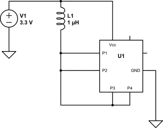

  • If the uC has on-board PLLs for clocks used in the chip, and if you can program the PLLs to exceed the safe clock rate substantially, it's possible to kill the chip by overheating. I'm not sure if this falls under your "normal uC's only" criterion, though. I have destroyed a chip in this way (forgot to disable the clock, and the PLL values were invalid), though it was not a microcontroller, and the PLLs that produced the clock were on a different chip. – dirkt Aug 17 '14 at 14:58

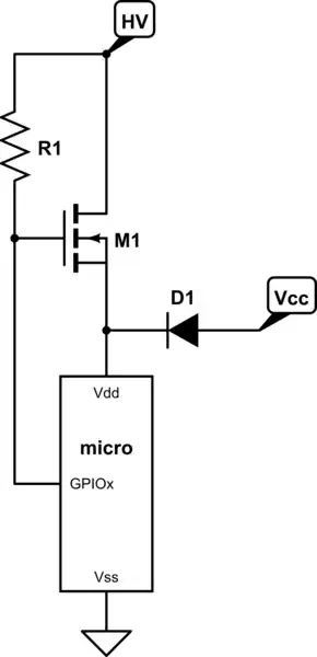

Even including some non purposely faulty connections possibly won't cut it: if you tie all the gpios to a power rail, setting them as output (to the opposite power rail) that can dissipate quite a lot of power. A gpio pin is probably protected against short circuit and such so nothing harmful will happen.
Designing an external circuit that destroys the chip at will is not trivial too in my opinion. The first thing that comes to mind needs a somewhat high voltage power supply, a nmos and a resistor:
simulate this circuit – Schematic created using CircuitLab Where:
  • \$V_{CC}\$ is the usual supply for the micro, some 3v3 to 5V or whatever is needed
  • HV is a supply which voltage is well above the absolute maximum ratings of the micro
  • D1 is there to protect your valuable 3V3 voltage source
  • R1 pulls the mosfet gate high when the micro is not keeping it to ground
  • M1 is the designated killer
the operation is simple: if the micro releases GPIOx M1 turns on, Vcc rises and your chip catches fire. Note that this is a crappy setup, for example HV must be turned on after you are extra sure that GPIOx is firmly held to ground. Some transistors might not like some -5V Vgs, and so on... But you get the picture.

One potential source of such destruction is SCR latchup, where unintended (intrinsic) transistors in a chip get together to form a kind of TRIAC which can then sink a lot of current. This can easily blow bond wires, and I've even seen plastic encased devices visibly warped because of the heat produced.
The typical cause is driving (even momentarily) an input to above or below the supply or ground rails respectively, but I guess you might see it happen if an input was left floating. And it's not then hard to imagine a circuit where the input's floating-ness was software controlled (although that would be a very silly thing to allow).

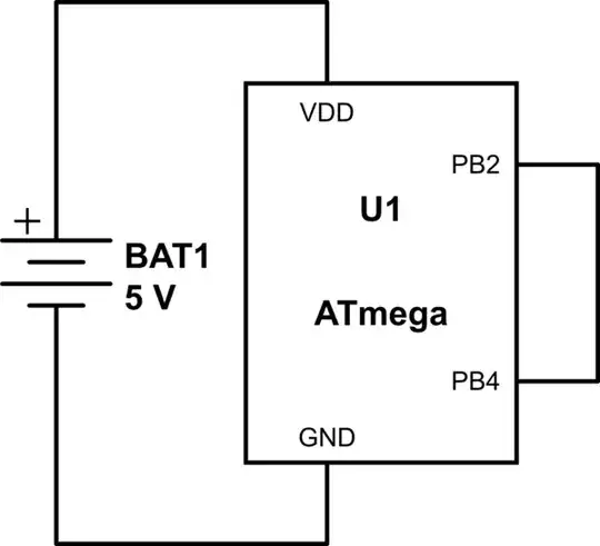

#include <avr/io.h>
int main(void)
    DDRB |= _BV(2) | _BV(4);
    PORTB |= _BV(2);
    PORTB &= ~_BV(4);
    for (;;);
The code above causes the MCU to push PB2 high while pull PB4 low, and this creates a short circuit from VDD to PB2 to PB4 to GND and quickly the port drivers of PB2 and/or PB4 will fry. The short circuit may be an innocent error like accidental soldering bridge.
Maxthon Chan
  • 2,853
  • I'm skeptical that this would work. IO pins usually can't source or sink large amounts of current. The IO driver transistors would limit the current. – Adam Haun Mar 24 '16 at 06:11
  • @AdamHaun The problem is that there is no current limiting exist. What is happening here is that this circuit can burn those transistors. – Maxthon Chan Mar 24 '16 at 06:13
  • The current limiting is from the size and gate voltage of the output drive transistors. Maybe a 5V AVR could burn out the drivers, but looking at ATMega typical driver strength charts, with 3V Vcc shorting two pins together might not even exceed the absolute max pin current. And the current goes down at high temp! Lower-power MCUs would probably be fine. – Adam Haun Mar 24 '16 at 16:29
