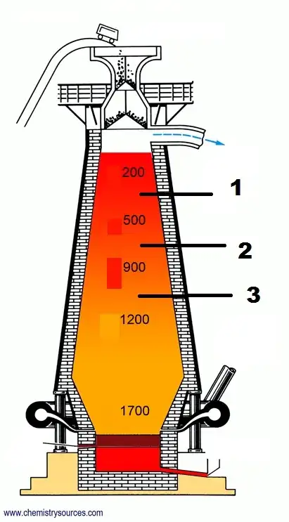

I'm working on blast furnace oven, I need to check if it's full with materials in levels one , two and three as shown :-
Representation of a furnace oven
The main problems:
It's very hot as you see in the picture (200°C to 900°C), thus I need to protect my sensors from this heat and also I need them not to be affected with the emissions.
Can I use IR sensors, camera or ultra sonic to solve this problem?
Update 1:-
The oven is used to melt down lime stones. I'm afraid that the heat could damage the sensors or that dropped stones may hit them.

  • What about what type of material you need to detect? That would help in choosing the sensor. Ultrasonic probably works but I think it would cost more than you are willing to pay. Maybe the material is conductive and some metallic probes can work... I don't know, try to add as much details as you can/want. – Vladimir Cravero Aug 07 '14 at 13:11
    How big is this furance? The cart at the top of the image makes it look very large. – Matt Young Aug 07 '14 at 13:15
  • @VladimirCravero It used to melt down lime stone , which for sure may hit the sensor while dropping from the hole , I'm afraid that ultrasonic may get effected by the heat – xsari3x Aug 07 '14 at 13:15
  • what Matt said, and I'd like to know also in what status is limestone in zones 1, 2 and 3. Is it already liquid? – Vladimir Cravero Aug 07 '14 at 13:17
  • It's 10 meters long , Lime stones status in all zones is solid , it just get some oxides off from it – xsari3x Aug 07 '14 at 13:20
  • If I was you, I would use the glass specially Silicon dioxide. http://en.wikipedia.org/wiki/Silicon_dioxide – Roh Aug 07 '14 at 13:35
  • Is the top open? Throw a rock down and measure how long it takes for the sound to come back. –  Aug 07 '14 at 17:40
  • Have you considered perhaps measuring what you put into the blast furnace before doing so, and keeping a tally. You're options here are going to be expensive and potentially insufficient monitoring devices, or something more simplistic that will probably work 80% of the time, as long as you do your math correctly. – Mike Aug 07 '14 at 21:25
  • What about using thermocouples? Thermocouples good to 1,300 C are easy to come by. – whatsisname Aug 19 '14 at 15:47

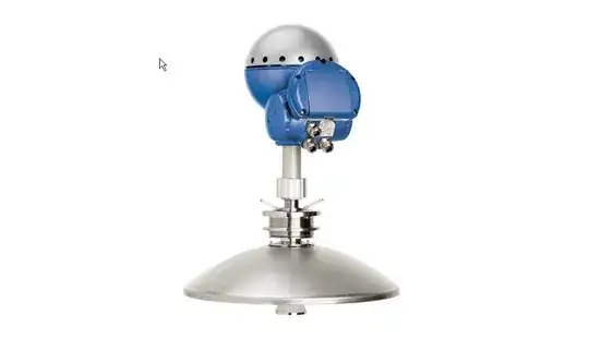

A radar sensor might work for you. This is a commercial 10GHz sensor.
http://www2.emersonprocess.com/siteadmincenter/PM%20Rosemount%20Documents/00813-0100-4024.pdf
Since the temperature at the top is not too bad for many dielectrics, you could design and construct a radome with purge air that would keep the worst of the fumes away from the sensor.
Spehro Pefhany
  • 376,485
  • 842
  • Can I have a link for this module ? – xsari3x Aug 07 '14 at 13:47
  • In the image description. – Spehro Pefhany Aug 07 '14 at 13:49
  • it's about 4000 $ ,,,, :D can I make a cheaper one ? ! – xsari3x Aug 07 '14 at 13:56
  • http://www.instrumart.com/products/25495/rosemount-5601-radar-level-transmitter ... 5000 USD – xsari3x Aug 07 '14 at 13:56
  • Yes that's about what I would expect for a quality commercial process control product. If you don't know radar you may be able to score a module. I would expect < $1K is possible. – Spehro Pefhany Aug 07 '14 at 14:14
    That seems to be how its been done before: http://www.instrumentation.co.za/news.aspx?pklnewsid=34490 – Scott Seidman Aug 07 '14 at 14:15
    $4k is surely a very small part of the cost of a blast furnace? – pjc50 Aug 07 '14 at 15:36
    I'm a boiler engineer, and radar level sensors are used in steam drums all the time, admittedly only up to about 300C. Purge air is used to cool certain types of sensor in the flue gas path, so I concur with that as well. I see the OP is a student, so this may be an academic question. The way this is solved in industry is to talk to your instrument supplier, for example Emerson, or the company in @ScottSeidman's link. – Level River St Aug 07 '14 at 20:36
