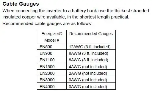

The manual for this inverter provides a handy gauge for determining what wire to use for your battery bank:
Wire gauge recommendations for inverter
Basically, it comes down to continuous vs intermittent operation. You can use thinner wires if you're not loading them fully or using them at high temperatures. The manual also discusses duty cycle so you can determine what inverter to use for various loads.
If your inverter supports it, and you plan on running it at 100% of capacity (3kW), then you might want to use two 4 AWG wires (per terminal) to share the current. (I used this current capacity (ampacity) chart (chassis wiring).)

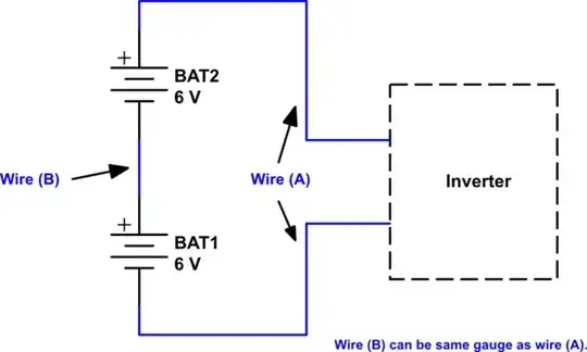

The wires connecting the batteries can be the same gauge as those connected to the inverter, as the current will be the same:

  • My inverter came with the necessary cables, I just need the connection wire for the two batteries – user3334776 Aug 06 '14 at 00:34
  • The wires connecting the batteries to each other can be the same gauge as the wires to the inverter. With the batteries in series, the current will be the same. – JYelton Aug 06 '14 at 00:47
