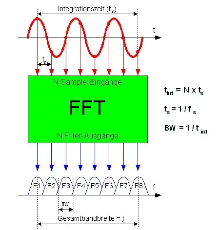

-4
look at this pic. its clear. relation between fs and fft resolution
Hamid
    It's not totally clear from this picture what's going on. (It doesn't help that the picture isn't in English.) What does this add that the other answers haven't mentioned? – Greg d'Eon Nov 09 '15 at 13:17
