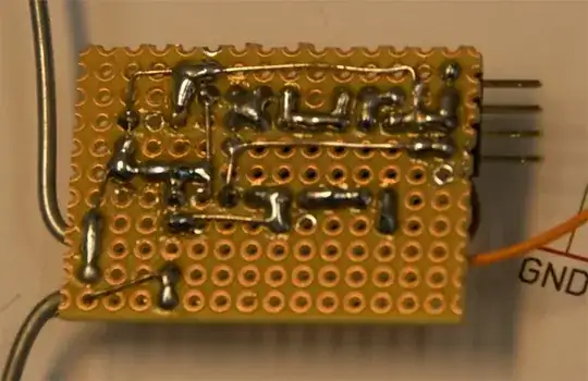

Yes in theory though it might be more trouble than it is worth. Heat up a strip of galvanized steel until it starts to sparkle indicating that the zinc is oxidizing. The resulting zinc oxide works as a crystal rectifier but it also has an amazing property called negative resistance. This allows it to be used as a replacement for a vacuum tube in a weak transmitter.
Google-fu or Yahoo-fu Crystodyne or the experimenter named Oleg Losev who developed the principle. Nyle Steiner does a lot of experimenting with forgotten tech like this. See this video. Also read this article by Hugo Gernsback.
Zo0tie
  • 41
  • +1 Good answer but need to break down into smaller paragraphs as I did. Use 'Google-fu or 'Yahoo-fu' to avoid signs of endorsements. –  Jul 01 '16 at 03:31
  • SPARK BANG BUZZ is Nyle Steiner's project website for no-tech radio ocillators, http://sparkbangbuzz.com, in particular see this 40M ham band CW xmitter http://sparkbangbuzz.com/zinc-osc-2/zinc-osc3.htm. Steiner also builds tiny cold-cathode vacuum tubes without needing expensive diffusion or turbo pumps. – wbeaty Sep 18 '16 at 00:03

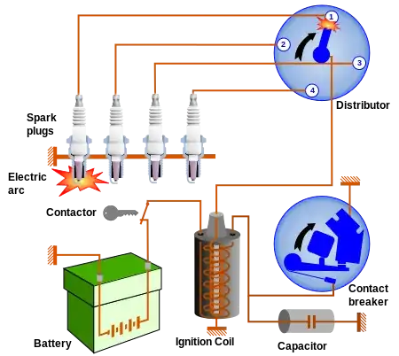

Another readily available method is use old car ignition coil and cam shaft switch breaker as this diagram (exclude the distributor) enter image description here (source)
Eduard Florinescu
  • 583
EEd
  • 989
    I included the image in the post, stackexchange policy is to include as much as possible in the answer in case in the future external links go down – Eduard Florinescu Aug 04 '14 at 21:15
