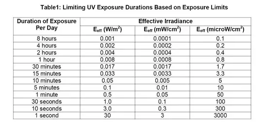

The emitted light power of those LEDs is UVA typically 10mW with a 15° 50% power angle. There's no maximum specified, but probably we could say more than 15-20mW would be very unlikely.
That's within the range where caution is called for. Here is a very detailed safety report from a large University. I'll reproduce a chart below, but note that it is based on exposure with 'breaks' to allow cellular repair to take place. Also, I would expect it's conservative.
If you get a bit of distance from then end of the LED, the power density drops with the square of the distance. If you allow an irradiance of 0.1mW/cm^2 (30 second exposure limit according to the chart), then you need to be at least distance \$d\$ from the LED:
$$d = \left(\sqrt\frac {P_{mW}}{Ir_{MAX}}\right) \frac{1}{\tan(7.5°)}$$
So if you allow 20mW at the LED you'd need a distance of more than about 1m to be safe for a ~30s exposure (and assuming the power is fairly well distributed over the center 'spot').
