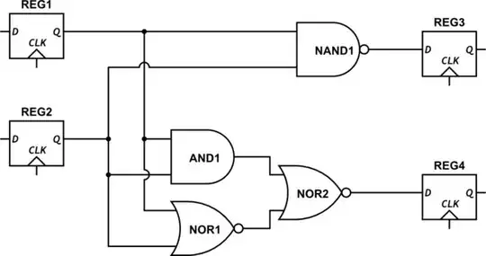

When you make a digital circuit the maximum clock frequency is determined by the so called "critical path": you have a clocked register, some combinational logic and another clocked register. If your clock period is shorter than the time required from the combinational logic to output a valid result then you have a problem. This requirement must be met for each possible input, so in the logic there usually is a longer path, the critical path, that is the most time consuming one. Have a look here:
Note that I omitted the clock signal for clarity (and laziness).
Assuming that each nand and each nor have the same propagation delay \$t_D\$, while the AND1 is built with two nand having a propagation delay of \$2t_D\$ you can see that the longest path is from REG1 (or REG2) to REG4 through AND1 and NOR2, the total delay being \$T_{D_{max}}=3t_D\$. Your clock can't be faster than this, so that $$f_{CK}\leq\frac{1}{T_{D_{max}}}$$

  2. Break the critical path with another D flip flop
The second option would make the longest path shorter, thus allowing higher clock frequencies.
