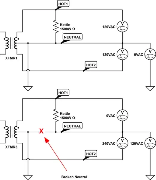

Consider this:
With the neutral wire broken, the "Neutral" at the socket will be at 120VAC relative to ground.
If another 1500W kettle was plugged in on the other side of the line, the voltage at the neutral would be around 0VAC relative to ground, however if a human were to contact the neutral wire and had a path to ground through their body, the voltage would not drop all that much and the person could be injured or killed.
If a 60W incandescent bulb was connected between Hot2 and Neutral, it would glow very brightly and quickly burn out. That's why changes in brightness of incandescent bulbs can be seen as a canary-in-the-coalmine for a flaky neutral connection.
