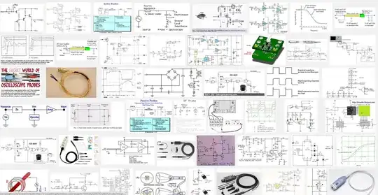

An immensely valuable resource is available via Google images.
Everyone know that you can search for things on Google.
Fewer people realise what you get when you repeat the same search using Google images.
The "a picture is worth 1000 words" adage tends to apply. Now, instead of reading text and trying to determine relevance, you can look at many pictures very rapidly and click on those which appear relevant visually.
Every picture is linked to a web page and, even if many do not cover what they may at first appear to, this still (usually) produces many good results immensely rapidly via the pictures.
Copying your exact question text into Google images, I used
  • circuit of active probe using FET trace CRO
To give this result
This is just a small part of the result. While not all are relevant, many are:
Try it. You'll like it.
Clicking on a few of those images which looked useful gave these results.
Some will be relevant to your query. There are many more.
