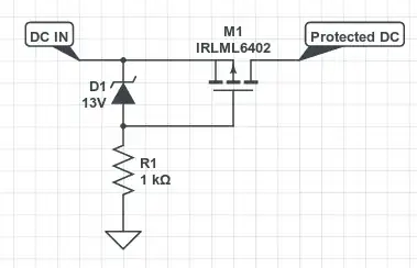

I need a simple circuit to protect my device from overvoltage (more than 13V). Typical working DC input voltage is 7-12V. Can I use this circuit:
Will it work?

No. If you apply 15VDC to the DC input yes the Zener will start to conduct, however this is a moot point since you have a large negative voltage from the gate to source of the PMOSFET. This will certainly drive it into saturation and DC IN will be connected directly to Protected DC with only Rds(on) between them.
A good way to picture it is if the zener is conducting with current flowing from cathode to anode, (which it will for DC inputs > 13V) replace it with a 13V battery with the negative terminal where the anode was and the positive terminal at the cathode and it will become clear that M1 will be driven to saturation.
ACD
  • 2,338
  • 26
  • OK, I understand. But can I modify the circuit to get it work? I need no very expensive circuit with many components. The overvoltage is very very rare situeation for me, but just in case I need a simple protection. –  Jul 17 '14 at 15:17
  • To offer a solution we need to know more details. What is the output driving? What are the load requirements? If it's little current and non-perfect regulation is needed then a Zener from GND to Protected DC might work. – ACD Jul 17 '14 at 15:20
  • Or a TVS/Zener to ground AFTER a PTC (Polyfuse) type device or even a conventional fuse. It all depends on your requirements. – John D Jul 17 '14 at 15:32
  • I add another attempt. Check please. –  Jul 17 '14 at 16:20
  • Closer, but you will need some sort of hysteresis, otherwise as you approach the threshold you could get oscillation, or get the FET into the linear region. Just off the top of my head you could experiment with a resistor from the collector of Q5 to the base of Q2. – John D Jul 17 '14 at 17:17
