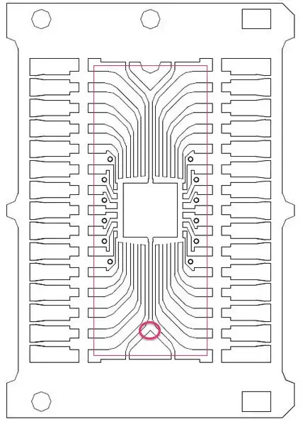

Here is a manufacturing drawing for a QFN ( a little more complicated than the package in the OP) On this I've drawn a red square which shows the boundary that the saw will cut on to define the package edge. Note: the N in QFN means "No Lead" the red circle shows the die attach stabilization structure as it is brought to the edge of the package.

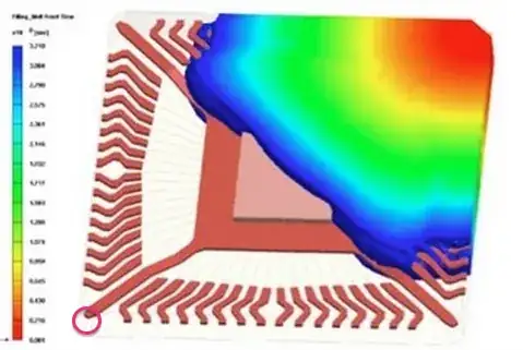

And finally here is a picture showing the moulding process being modeled. I've put a red circle on this to show the die attach stabilization structure again. The external frame is not shown in this picture.

As you can see in the center there is the die, supported by a metal plate. All the pins are brought near the die with these metal fins. Now look at this:
All the fins are connected together before being like in the first image. You have this big frame with lots of "die supports" connected together. You place and glue the die, wire bond it, put some plastic then cut the chip from the frame. When you cut it these tiny copper/Al/whatever metal fins is all what remains from the former frame.
