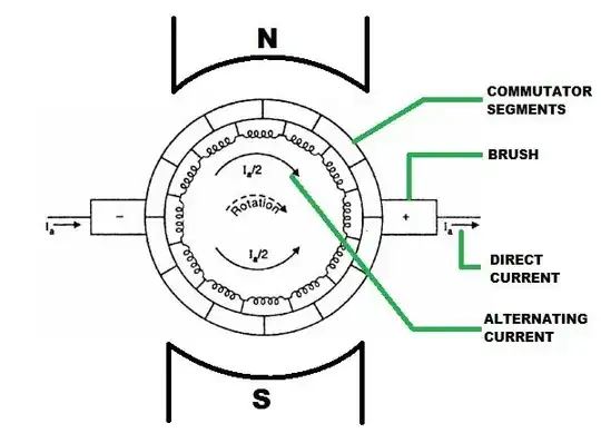

You'll be seeing some small variation due to commutator resistance, and which varies as the brushes travel over the commutator, plus (and more importantly) the shorting of segments of the winding as the brushes cross sectors.
The variation should be \$K\cdot \frac{N}{4}\$ to \$K\cdot\frac{N-2}{4} \$ where N is the number of poles. In other words if there are 12 poles, the resistance will vary by about +/-9% as the shaft rotates. See the diagram from this web page here.
In theory this (I think the average would be what you want) would be the resistance used in \$I\cdot R\$ compensation, but it might in reality be a bit different because other things are folded into it such as resistance of wiring to the motor.
