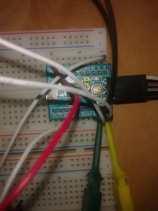

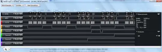

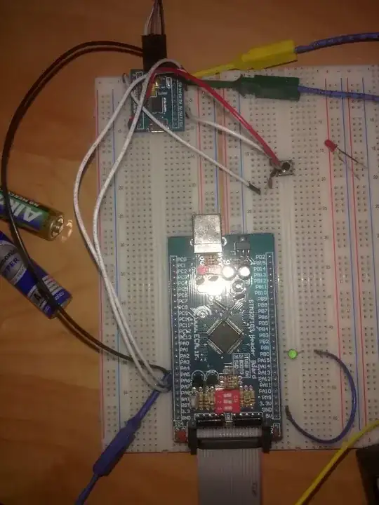

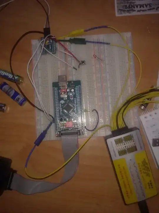

I'm working on a simple project. I want to send a string. the string is "Rohalamin". the second board after recieve the string should turn on the LED.
the program for first board is (the MCU for this board is STM32F030F4):

several pictures of my project:
the circuit doesn't work. I don't know why! My Saleae logic shows me this:
figure4
What's the problem?
Edit: I changed the codes and Now they work better! the first problem was that I forgotten to high and low the NSS pin. I changed the code and now it works better than before. as you can see in Saleae, the data is odd (in other word, it's not "Rohalamin").

You are getting some data transfer according to your logic analyzer, so you can't be too far off. Assuming it's not just a simple wiring fault, it's likely to be the bus configuration.
SPI has various different configuration options - whether the data is sent on the rising or falling edge of the clock, and where abouts in the clock cycle it should be sampled. Make sure that what you have configured on your microcontroller matches what the slave device expects. See the data sheet for the slave device, and "mode numbers" here, to select the correct CLKPPolarity and CLKPhase. Also make sure that the clock rate you've chosen is not higher than the slave can support.
You need to make sure that the logic analyzer software is configured in the same way, too, by clicking on the little cog icon on the right. Finally, just in case you don't know: the logic analyzer may start capturing in the middle of a byte, so you may need to tell it where a byte starts. Do this by clicking on the underlined "T1" on the right, then clicking at the start of a byte in the graph.
